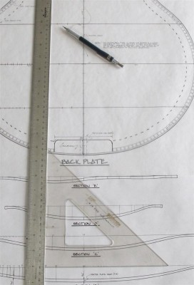

Re: first back carve update
Benedetto has in his book a small depiction of a top with some drilled holes and lines circling around. My understanding is that you start with a 1" thick piece of wood, and the outer rim is 1/4". That would leave 8 steps of 3/32" to amount to 1". Do I have this right?

Re: first back carve update I finally get it
Ive stared at this pic for days and it finally clicked,i dont know why I couldnt understand what was shown.thanks to who ever posted this pic,really thanks alot.I saw the rule square and pen as props,but finally realised what was being shown was the transfer of the arch height for each section from one view to another, I guess im alot slow when it comes to reading blue prints.
