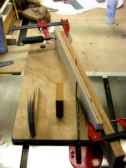

I use this jig, which I gleaned from Kathy Matsushita's site. I added the piece in the middle of the image.
It helps with clamping to keep things from skating around.
The surfaces that could cause the neck parts to get glued to the jig are covered with clear packing tape.
Works real well.

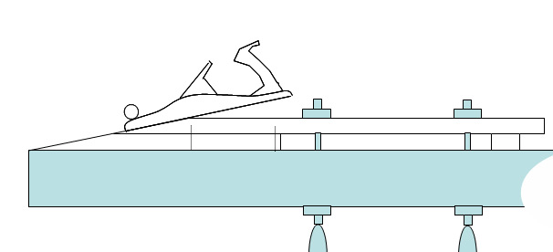

These are all great suggestions. Please pay particular attention to Todd Stock's schematic drawing which shows how to plane the mating surfaces. On the first two necks I ever made, I was in your position: Not enough capacity on my small table saw and no band saw at that time. I made my cuts very carefully with a back saw. This got me closely in the neighborhood. Then I used Todd's method to clean up and prepare for glueing. A good, small try square is very helpful to check the squareness and flatness of your surfaces as you go. One other thing: It is also possible to sand your mating surfaces using Todd's set-up and a large, flat sanding block. I've done that, too. But most people prefer a planed surface for glueing on a critical joint like this. If you sand, just be fastidious about cleaning all dust and sanding residue from the surfaces. Sweep it, blow it or vacuum it and wash it with naphtha or alcohol, too. All that said, I believe you'd prefer a sharp, well-tuned plane. Best of luck!
