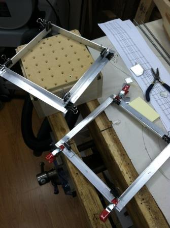

The basic bits and pieces of a plastic thermoforming setup are: heat source, vacuum table, a mold of the thing you want to make, and thermoformable plastic. I used 1/16" black ABS. The plastic is heated to is thermoforming temperature (around 300deg F), you place it on the vacuum table over the mold, turn on the vacuum, and it sucks down over the mold. Now, as I found out, this sounds a lot simpler than it is, and there has been A LOT of manufacturing R&D over the decades and information out there that can give you fairly predictable outcomes. I, of course, jumped right in and learned some things the hard way.

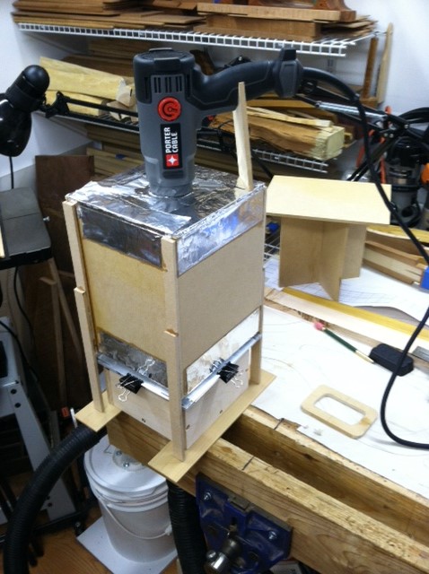

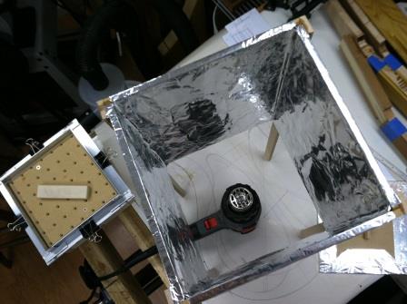

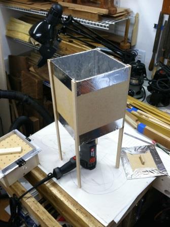

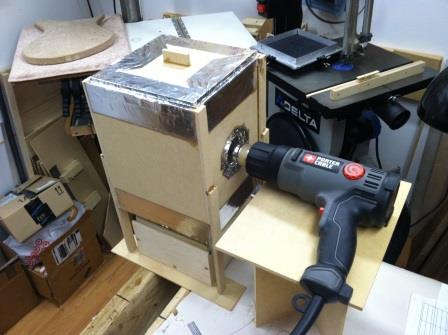

Here is my heat source. It's a Porter Cable heat gun and an "oven" that I made. My idea was to place the plastic in this aluminum frame over the "oven" to heat it. Seemed like a good idea, but I was not getting even and sufficient heating. Here are some first failed attempts with a dummy mold. One even turned out pretty well, after I blasted it with more heat until the edges sucked all the way down.

After some advice from folks on the MEF, I reconfigured the heat gun and oven to keep more hot air in the box.

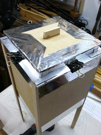

Unfortunately, while it did make for more consistent heat, now the air was blowing unevenly on the plastic, creating hot/thin spots. I reconfigured once again and it now looks like this.

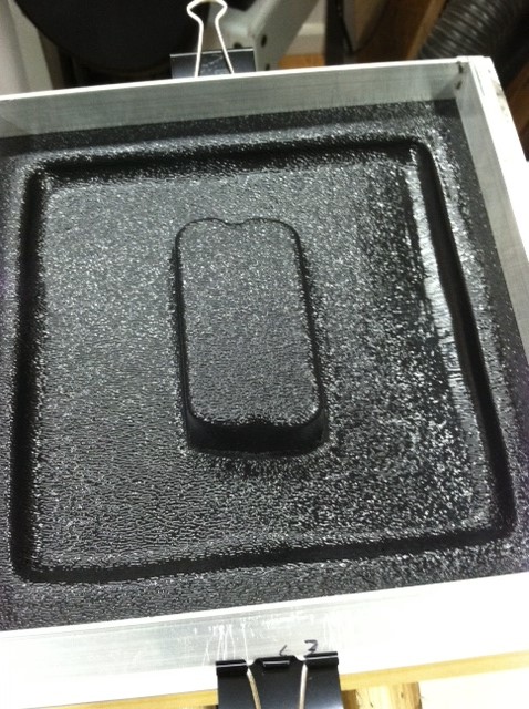

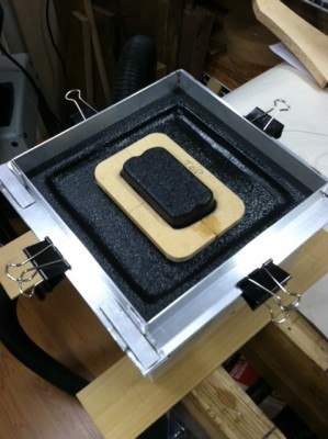

This arrangement worked the best, and I made a change to the table, as well, to seal the edge better. I still wasn't getting good draw-down on the plastic, though. These attempts are now using the actual pickup mold for the pickups I'm going to build.

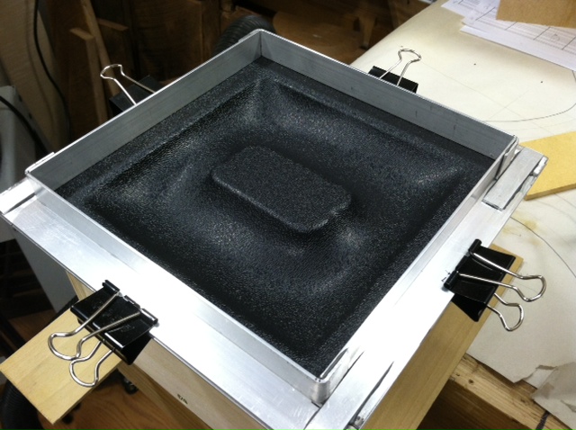

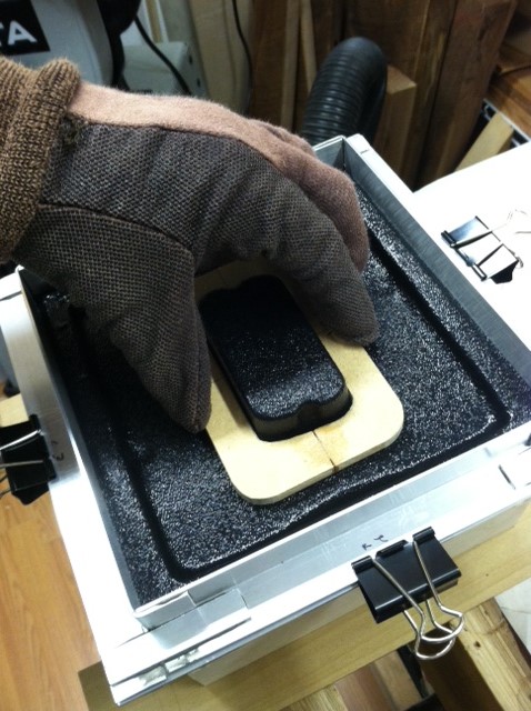

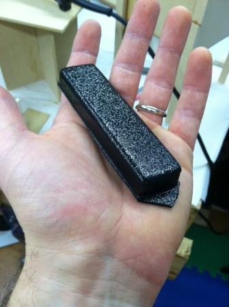

While watching some youtubes of folks doing vacuum forming at home, I noticed some guys actually pressing the plastic down with gloved fingers to get edges pulled down completely. This seemed like a bad idea, as I was sure that it would create this spots or ugly deformities, but the plastic is already cooled enough that it's not a problem. I tried pushing the edges with a piece of wood, and it turned out pretty well. To improve upon that idea, I made a ring, just slightly bigger than the base of the pickup mold, to press the last 1/4" to 3/8" of plastic down evenly around the edges.
Not shown are some of the bigger failures, including blistering and tearing of the plastic, due to overheating. If you're interested in giving this a try, read up on some of the info out there. Even plastic heating is a very important aspect, and there are some very specific recommendations for mold height vs. sheet area.
If I was going to do this again, I'd build a bigger table, maybe 12x12. There is a LOT of waste, but if the plastic area is too small, you run the risk of stretching/thinning the plastic or not getting the detail you want. I'd also look into heating with a heat lamp instead of blown air.
Fire away with any critique or questions! Thanks for looking!

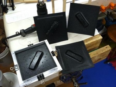

This worked so well, that I busted out four more identical covers!
This whole adventure didn't end up costing much. The heat gun was $35. The quarter sheet of ABS was about $15. The plywood and hardboard used for the vacuum table, oven, and molds were odds and ends I had around the shop. The aluminum 'L' stock for the plastic holding frames was about $15.Not shown are some of the bigger failures, including blistering and tearing of the plastic, due to overheating. If you're interested in giving this a try, read up on some of the info out there. Even plastic heating is a very important aspect, and there are some very specific recommendations for mold height vs. sheet area.

Nice work!!
Now you can form fit guitar cases.

The oven space is small enough that it gets plenty hot, pretty quick. The upward blowing oven arrangement probably would have worked fine if I closed off the bottom a little, but the plastic was cooling too much as I moved the frame over to the vacuum table. One of the participants on the Music Electronics Forum, a manufacturing engineer by trade, made the suggestion to put the oven over the plastic as it sits on the table, so the table gets warm, too, and the vacuum can be pulled immediately.Hans Bezemer wrote:Cool project Jason,

Success ended up being more about the directional flow of the forced air. This heat gun has a low and high fan setting, like a blow-dryer, and I set it on high to keep the temperature up (thermostat set at about 75%) and on the plastic. Even on a 7"x7" square surface, if the air was moving a little faster in one area over another, that spot would get too hot and thin or tear when the vacuum was applied (see picture). I made a small baffle/interrupter thing that is suspended in the center of the oven to disperse the air a little more randomly, but I still found one side getting a bit too hot (you can see this in some of the last pictures, on the right side of the plastic). I could probably change the temperature setting, and slow down the fan, but this would require a longer "cooking" time: these attempts had a timer set for 8 minutes. For what I'm doing, I think this is going to work just fine, and I feel confident that I could build other pickup molds and get similar results.

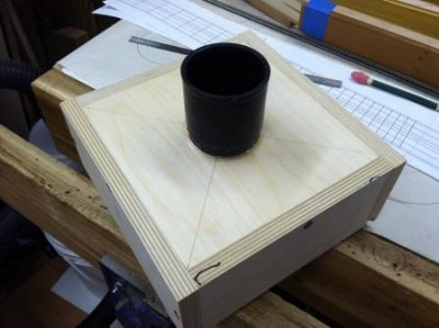

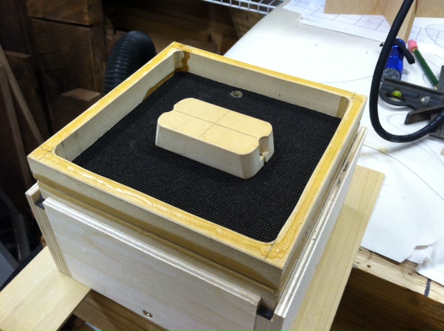

By the way, I realize that my pictures focused a lot on the product and not the tools. The vacuum table is pretty simple - ply box with a 3/4" hardboard table - and uses the shop vac for vacuum. (I do have a vacuum clamp/press system, but this process needs some super-fast, big-volume suck.) When I upgraded the table, I put a lip around the edge to seal the plastic, and drywall sanding sheet on the table to improve air flow around the mold. These ideas I got from some youtube videos.
The oven is just 1/4" hardboard, with a couple layers of aluminum foil on the inside (held with foil tape). The sides get pretty warm, but not enough to burst into flames.

I think a heat lamp would be a better heat source.
On the vacuum side, I'd try to use both the shop vac and your vacuum press system. Plumb it so that each system can be opened and closed via valves, then use the shop vac to pull the initial vacuum then quickly switch to the vacuum press system to pull the final, stronger vacuum, while keeping the heat lamp on it.
Just some thoughts...
Re: Jason's vacuum thermoforming adventures
Using the vacuum press for the secondary suck is a good idea. The shop vac is working pretty hard, basically pulling against nothing, and the vacuum press is made for that.Mario Proulx wrote:I think a heat lamp would be a better heat source.
Yes, I think a lamp might be a better heat source. It would be easy to wire a ceramic outlet onto that lid.
