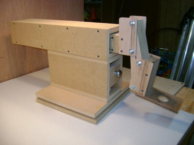

I was always curious about the machine that is stationary where the router rides up and down on an assembly so I built one of those as well. What else can you do with scraps of MDF and feel somewhat accomplished at the end of the day? Anyway, there it stands ready for a trial. Here are my initial thoughts on both machines:
Armed type:
1. Pro - This unit operates very smoothly and the arm takes the weight off of the router.
2. Con - Sawdust goes everywhere since you are revolving the router around the body.
3. Con - You have to 'get down there' and watch the unit going around the body and it does not stay perfectly vertical to the sides since there is an articulated carriage. You have to hold it vertical because in order to use it, the carriage has to be a little loose.
4. Con - Takes up more room.
5. Pro - Doesn't really matter what kind of body cradle you use as long as the sides are vertical.
6. Con - A bit unsafe with a gyrating router in your hands.
7. Pro - I put a drawer for bit and bearings.

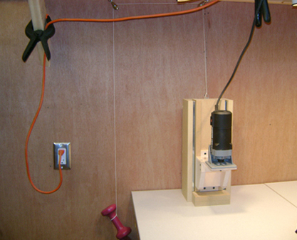

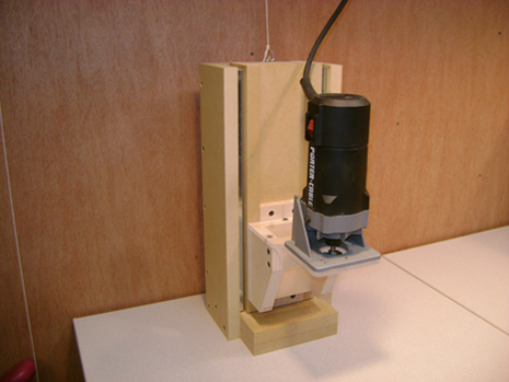

Up and Down type:
1. Pro - Takes up little space.
2. Pro -Router shaft and cutter stay vertical.
3. Con - Carriage is too heavy to simply sit on the edge of the guitar so a counterweight or spring mechanism needs to be employed. You'll note a temporary counter weight on mine with little pulleys and approx 5 pounds of offsetting weight. Not a big deal.
4. Pro - It just feels safer. I mean, I slipped on the armed one and my thumb went right into the cutter (luckily on the tightening nut and not the bit).
5. Con - You need to build a cradle that won't get in the way as you turn the body around.
6. Pro - dust collection is possible with a stationary cutter.
7. Con - No place for bits or bearings...Have to get creative here.
Armed type:
Up and Down type:

I built the extending arm ("Williams jig," right?) style and used it once so far. Worked fine, though I'll need to be careful how much pressure I put on the bearing next time: it put a dent/groove in the cherry all around the sides. I use a RIDGID lam trimmer.
Yes, thumbs-up on the little drawer you incorporated!

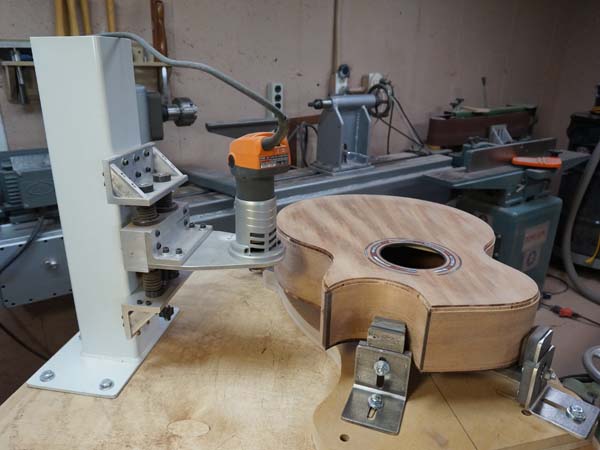

Here is the one I made and been using for 10+ years now.
Very simple, super strong, solid and smooth running.
Four linear bearing in an aluminum block riding on two hardened linear shafts mounted between two aluminum angle brackets. The guitar body is supported on four hard rubber lined, adjustable angle iron supports. The support are bolted down to inserts in the base and the supports adjust in and out and up and down to fit different guitar model body shapes. The body supports can bolted in different places around the support base for different models and for cutaway.
The router and the plate it's bolted to are easily switched out for different binding channel cuts.

It's true you can do it by hand with success. But having done it both ways the machine I built is much more precision especially with elaborate bindings and around the points of a cutaway.
I have the room and like building jigs, machines and tools almost as much as guitars. The big tail stock in the background is part of huge 800+ lb, 20" swing, variable speed wood lathe I built using heavy steel tubing.

This quote is from Bill Raymond and I would very much like to see a picture of his hinge application. Maybe Bill's design is a better method so the articulation isn't so loose feeling.I used 4 lengths of piano hinge;
I am going to put the vertical model through its paces soon. I have it counterweighted right now but like the idea of using springs as another member mentioned so there is still some tweeking to do. I guess when you feel comfortable with the tools and the process you can concentrate on the guitar instead of worrying about each 'next step'. For example, I have never shot lacquer nor do I have the tools for it yet. That will be another Forum discussion.
