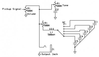

The varitone is a simple circuit. You have a coil and a cap in series going from the pickup output to ground. A switch allows you to change the value of the cap. The voltage level of the signal coming out of a pickup is so small that you really don't need to have much of a concern with the voltage value. You can have any amount of switching positions but I believe that the original Gibson Varitone had six positions. One of those six was a non-connected position which removed the varitone from the circuit. I got an original schematic from Gibson a few years ago and it indicated that the inductor value was 1 Henry. I never found a 1 Henry coil but I had good luck using one side of a small audio transformer like you'd find in a little transistor radio. I made this schematic to show a Varitone in a typical guitar. I included a potentiometer that allows you to control the amount of influence the Varitone has on the signal. If you eliminate the switch and the coil, and use just one of the five caps, the Varitone circuit is incorporated in the same manner as a conventional tone control. On my Varitone circuits, I use a .005uf, .022uf, .047uf (or .050uf) and a .1uf. I use a five position switch and only four caps.
