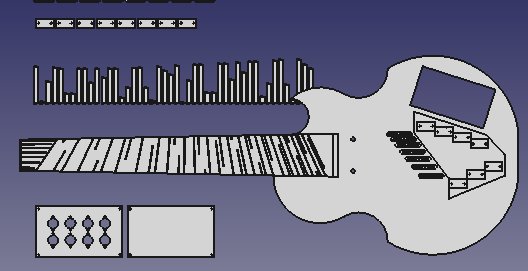

a screenshot of what I have so far:

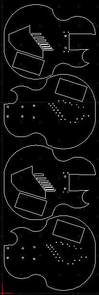

The date is set!
I have an apointment on 20th of june. Then the parts will be cut on the watercutter.
That makes for the following to do list:
- Finishing the 3D drawing
- Creating 2D drawings from the 3D drawing for all the different parts
- Creating a file for the watercutter with instructions what to cut in which order
One of the things I think is funny / weird is that I've already spend many hours on the project without touching one tool.

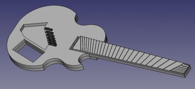

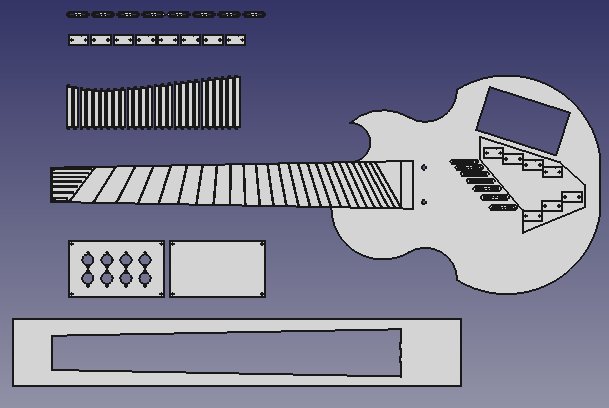

I'm done make the script and made a first 3D-drawing of prototype #1.
I've copied some parts out of the drawing to make it easier to select them when needed.
From this 3d-file I'll make 2D-files for every part and the parts will be put together in one drawing, which will be used to calculate the cutting sequence of the cutter.
I want to cut out my frets from stainless steel.
The second prototype will be similar only fretless.
Because I have some material left, I also want to make a third prototype. This prototype will have a microtonal fretboard with 31 equal tempered divisions instead of the regular 12 divisions.
Because of the smaller intervals, it is possible to make a distinction between an A-flat and a G-sharp, which isn't possible on a regular fretted instrument (apart from making a bend).
Downside is that you get a lot of frets.
When playing only in the 12 regular keys, not all the notes are necessary and therefore some frets are not needed then, see this example (comments are in Dutch). I've made a quick scetch and it is possible to leave some frets out and make some only for a couple of strings. I have to alter my script slightly but it is easily done.
Hans
For those interested I'm using the opensource software program FreeCAD.
And have included my script. This can be inserted in the program by copy and pasting it in the Python-console (After opening FreeCAD, click view-->views-->Python console)

def xintersectline(rc1,b1,rc2,b2):
  x = (b2-b1)/(rc1-rc2)
  return x
def yintersectline(rc1,b1,rc2,b2):
  y = (b2-rc2*b1/rc1)/(1-rc2/rc1)
  return y
def distbtwopoints(x0,x1,y0,y1):
  dist = math.sqrt((y1-y0)**2+(x1-x0)**2)
  return dist
for i in range(0,numberfrets+1):
  xbass.append(slbass-slbass/2**(i/octavedivider))
  ybass.append(-(widthnut/2.0+(widthbridge-widthnut)/2.0*xbass[i]/slbass))
  xtreble.append(offsetnut+sltreble-sltreble/2.0**(i/octavedivider))
  ytreble.append((widthnut/2.0+(widthbridge-widthnut)/2.0*xtreble[i]/slbass))
  rcfret.append((ytreble[i]-ybass[i])/(xtreble[i]-xbass[i]))
  bfret.append(ybass[i]-rcfret[i]*xbass[i])
  # length fret
  xfretdistbass = xintersectline(rcfret[i],bfret[i],rcsideneckbass,bsideneckbassfretdist)
  yfretdistbass = yintersectline(rcfret[i],bfret[i],rcsideneckbass,bsideneckbassfretdist)
  xfretoffsetbass = xintersectline(rcfret[i],bfret[i],rcsideneckbass,bsideneckbassfretoffset)
  yfretoffsetbass = yintersectline(rcfret[i],bfret[i],rcsideneckbass,bsideneckbassfretoffset)
  dist1 = distbtwopoints(xfretdistbass, xfretoffsetbass, yfretdistbass, yfretoffsetbass)
  xfretdisttreble = xintersectline(rcfret[i],bfret[i],rcsidenecktreble,bsidenecktreblefretdist)
  yfretdisttreble = yintersectline(rcfret[i],bfret[i],rcsidenecktreble,bsidenecktreblefretdist)
  xfretoffsettreble = xintersectline(rcfret[i],bfret[i],rcsidenecktreble,bsidenecktreblefretoffset)
  yfretoffsettreble = yintersectline(rcfret[i],bfret[i],rcsidenecktreble,bsidenecktreblefretoffset)
  dist2 = distbtwopoints(xfretoffsettreble, xfretdisttreble, yfretoffsettreble, yfretdisttreble)
  distfretbasstreble = distbtwopoints(xfretdistbass,xfretdisttreble,yfretdistbass,yfretdisttreble)
  distbetwnoffsets = distbtwopoints(xfretoffsetbass,xfretoffsettreble,yfretoffsetbass,yfretoffsettreble)
  V1temp = Base.Vector(0,0,0)
  V2temp = Base.Vector(dist1,0,0)
  V3temp = Base.Vector(dist1,0,-thfretboard+depthfret)
  V4temp = Base.Vector(distfretbasstreble-dist2,0,-thfretboard+depthfret)
  V5temp = Base.Vector(distfretbasstreble-dist2,0,0)
  V6temp = Base.Vector(distfretbasstreble,0,0)
  V7temp = Base.Vector(distfretbasstreble,0,heightfret-1)
  V8temp = Base.Vector(distfretbasstreble-1,0,heightfret)
  V9temp = Base.Vector(1,0,heightfret)
  V10temp = Base.Vector(0,0,heightfret-1)
  L1temp = Part.Line(V1temp,V2temp)
  L2temp = Part.Line(V2temp,V3temp)
  L3temp = Part.Line(V3temp,V4temp)
  L4temp = Part.Line(V4temp,V5temp)
  L5temp = Part.Line(V5temp,V6temp)
  L6temp = Part.Line(V6temp,V7temp)
  L7temp = Part.Line(V7temp,V8temp)
  L8temp = Part.Line(V8temp,V9temp)
  L9temp = Part.Line(V9temp,V10temp)
  L10temp = Part.Line(V10temp,V1temp)
  Sfrettemp = Part.Shape([L1temp,L2temp,L3temp,L4temp,L5temp,L6temp,L7temp,L8temp,L9temp,L10temp])
  Wfrettemp = Part.Wire(Sfrettemp.Edges)
  Ffrettemp = Part.Face(Wfrettemp)
  Pfrettemp = Ffrettemp.extrude(Base.Vector(0,widthfret,0))
  Pfrettemp.translate(Base.Vector(0,-0.5*widthfret,0))
  Pfrettemp1 = Pfrettemp.copy()
  Pfret.append(Pfrettemp1)
  afrettemp = math.atan2(yfretdisttreble-yfretdistbass,xfretdisttreble-xfretdistbass)
  Pfrettemp.rotate((0,0,0),(0,0,1),afrettemp*180./math.pi)
  Pfrettemp.translate(Base.Vector(xfretdistbass,yfretdistbass,thicknessneck+thfretboard))
  Fretnr = "Fret"+str(i)
  Fret = FreeCAD.ActiveDocument.addObject("Part::Feature",Fretnr)
  Fret.Shape = Pfrettemp
  grp.addObject(Fret)
  L1cuttemp = Part.Line(Base.Vector(0,0,0),Base.Vector(0,0,-thfretboard))
  L2cuttemp = Part.Line(Base.Vector(0,0,-thfretboard),Base.Vector(distfretbasstreble-dist1-dist2,0,-thfretboard))
  L3cuttemp = Part.Line(Base.Vector(distfretbasstreble-dist1-dist2,0,-thfretboard),Base.Vector(distfretbasstreble-dist1-dist2,0,0))
  L4cuttemp = Part.Line(Base.Vector(distfretbasstreble-dist1-dist2,0,-0),Base.Vector(0,0,0))
  Scuttemp = Part.Shape([L1cuttemp,L2cuttemp,L3cuttemp,L4cuttemp])
  Wcuttemp = Part.Wire(Scuttemp.Edges)
  Fcuttemp = Part.Face(Wcuttemp)
  Pcuttemp = Fcuttemp.extrude(Base.Vector(0,widthfret,0))
  Pcuttemp.translate(Base.Vector(0,-0.5*widthfret,0))
  Pcuttemp.rotate((0,0,0),(0,0,1),afrettemp*180./math.pi)
  Pcuttemp.translate(Base.Vector(xfretoffsetbass,yfretoffsetbass,thicknessneck+thfretboard))
  Pcut.append(Pcuttemp)
# drawing outline
## points
xoffset = 30
yoffset = (widthnut/2.0-(widthbridge-widthnut)/2.0*xoffset/slbass)
V1 = Base.Vector(-xoffset,-yoffset)
V2 = Base.Vector(xneckbass,yneckbass)
V3 = Base.Vector(xnecktreble,ynecktreble,0)
V4 = Base.Vector(-xoffset,yoffset)
## lines
L1 = Part.Line(V1,V2)
L2 = Part.Line(V2,V3)
L3 = Part.Line(V3,V4)
L4 = Part.Line(V4,V1)
## make a part and wire of it
S1 = Part.Shape([L1,L2,L3,L4])
W1 = Part.Wire(S1.Edges)
F1 = Part.Face(W1)
P1 = F1.extrude(Base.Vector(0,0,thicknessneck))
P2 = F1.extrude(Base.Vector(0,0,thfretboard))
P2.translate(Base.Vector(0,0,thicknessneck))
## Cutout for trussrod
diffbetweentrussrods = (widthnut-numbertrusrod*Trussrodwidth)/(numbertrusrod+1)
cutouttrussrod1 = Part.makeBox(2,Trussrodwidth,thicknessneck)
cutouttrussrod2 = cutouttrussrod1.copy()
cutouttrussrod1.translate(Base.Vector(xneckbass-2., -0.5*widthnut+diffbetweentrussrods,0))
cutouttrussrod2.translate(Base.Vector(xneckbass-2., 0.5*widthnut-diffbetweentrussrods-Trussrodwidth,0))
P1 = P1.cut(cutouttrussrod1)
P1 = P1.cut(cutouttrussrod2)
Pcutjigrouter = P1.copy()
## cutout for strings
sdoffsettreble = (sdnuttreble-(sdbridgetreble-sdnuttreble)*xoffset/slbass)
sdoffset = []
sdoffset.append(0)
for i in range(0,(len(diastr)-1)):
  sdoffset.append(sdoffsettreble*factorsd**(len(diastr)-2.-i))
for i in range(len(diastr)):	# Note: cutout is 20% wider at the end then with 0 fret
  diastrtemp = diastr[0:i+1]
  sdnuttemp = sdnut[0:i+1]
  sdbridgetemp = sdbridge[0:i+1]
  sdoffsettemp = sdoffset[0:i+1]
  ynut = -widthnut/2 + sdside + sum(diastrtemp) - diastr[i] + sum(sdnuttemp)
  ybridge = -widthbridge/2.0 + sdside + sum(diastrtemp) - diastr[i] + sum(sdbridgetemp)
  xtemp1 = -xoffset
  ytemp1 = -yoffset + sdside + sum(diastrtemp) - diastr[i] - 0.1*diastr[i] + sum(sdoffsettemp)
  xtemp2 = xbass[0]+(xtreble[0]-xbass[0])*(ynut+widthnut/2.0)/widthnut - 5.0
  ytemp2 = ynut + (ybridge-ynut)*xtemp2/slbass
  xtemp3 = xtemp2
  ytemp3 = ytemp2 + diastr[i]
  xtemp4 = -xoffset
  ytemp4 = ytemp1 + 1.2*diastr[i]
  Vtemp1 = Base.Vector(xtemp1,ytemp1)
  Vtemp2 = Base.Vector(xtemp2,ytemp2)
  Vtemp3 = Base.Vector(xtemp3,ytemp3)
  Vtemp4 = Base.Vector(xtemp4,ytemp4)
  Ltemp1 = Part.Line(Vtemp1,Vtemp2)
  Ltemp2 = Part.Line(Vtemp2,Vtemp3)
  Ltemp3 = Part.Line(Vtemp3,Vtemp4)
  Ltemp4 = Part.Line(Vtemp4,Vtemp1)
  Stemp = Part.Shape([Ltemp1,Ltemp2,Ltemp3,Ltemp4])
  Wtemp = Part.Wire(Stemp.Edges)
  Ftemp = Part.Face(Wtemp)
  Ptemp = Ftemp.extrude(Base.Vector(0,0,thfretboard))
  Ptemp.translate(Base.Vector(0,0,thicknessneck))
  P2 = P2.cut(Ptemp)
## Cutting fretslots
  P2 = P2.cut(Pcut[i])
## Drawing mounting holes
cylindermountingneck = Part.makeCylinder(rneckbolts*0.8,thicknessbodyplate)
cylmneck1 = cylindermountingneck.copy()
cylmneck2 = cylindermountingneck.copy()
cylmneck3 = cylindermountingneck.copy()
cylmneck4 = cylindermountingneck.copy()
cylmneck1.translate(Base.Vector(slbass-slbass/2**(fretwherebodymeetsneck/octavedivider)+20.0,0.4*widthnut,0))
cylmneck2.translate(Base.Vector(slbass-slbass/2**(numberfrets/octavedivider)-20.0,0.4*widthnut,0))
cylmneck3.translate(Base.Vector(slbass-slbass/2**(fretwherebodymeetsneck/octavedivider)+20.0,-0.4*widthnut,0))
cylmneck4.translate(Base.Vector(slbass-slbass/2**(numberfrets/octavedivider)-20.0,-0.4*widthnut,0))
P1 = P1.cut(cylmneck1)
P1 = P1.cut(cylmneck2)
P1 = P1.cut(cylmneck3)
P1 = P1.cut(cylmneck4)
Neck = FreeCAD.ActiveDocument.addObject("Part::Feature","Neck")
Neck.Shape = P1
Fretboard = FreeCAD.ActiveDocument.addObject("Part::Feature","Fretboard")
Fretboard.Shape = P2
# Drawing the body
werkelijkeafstand = math.hypot(xend,yverschil)				# de werkelijke afstand van het begin van de hals langs de schuine zijde tot helemaal naar achteren
werkelijkelengthbody = lengthbody*werkelijkeafstand/xend		# de lengte van de lijn waar ik de cirkeldelen op ga berekenen is langer, dit wordt hier berekend
# berekenen vectoren waar de cirkeldelen uitgemaakt worden.
rgroteboog = (werkelijkelengthbody/goldenratio)/2.0
xcentregroteboog = werkelijkelengthbody-rgroteboog
rkleineboog = (werkelijkelengthbody/math.pow(goldenratio,2))/2.0
xcentrekleineboog = rkleineboog
rcutaway = (werkelijkelengthbody/math.pow(goldenratio,3))/2.0
rcutaway2 = (werkelijkelengthbody/math.pow(goldenratio,4))/2.0
d = rgroteboog+rkleineboog	# uitrekenen van snijpunt grote en kleine boog en straal van midden cirkeldeel
xcentremidden = (d**2.0-(rgroteboog+rcutaway)**2.0+(rgroteboog)**2.0)/(2.0*d)
ycentremidden = ((4*d**2.0*(rgroteboog)**2.0-(d**2.0-(rgroteboog+rcutaway)**2.0+(rgroteboog)**2.0)**2)/(4*d**2))**0.5
angle1centremidden = math.atan2(ycentremidden,xcentremidden)
angle2centremidden = math.atan2(ycentremidden,xcentremidden)
d2 = rkleineboog
xVb0 = werkelijkelengthbody
yVb0 = 0
xVb1 = werkelijkelengthbody-rgroteboog
yVb1 = rgroteboog
xVb2 = math.cos(angle2centremidden)*rgroteboog+rgroteboog
yVb2 = math.sin(angle2centremidden)*rgroteboog
xVb3 = rkleineboog + xcentremidden
yVb3 = ycentremidden-rcutaway
xVb4 = rkleineboog + math.cos(angle1centremidden)*rkleineboog
yVb4 = math.sin(angle1centremidden)*rkleineboog
xVb5 = rkleineboog
yVb5 = rkleineboog
xVb6 = rcutaway2
yVb6 = 2*rcutaway2
xVb7 = 2*rcutaway2
yVb7 = rcutaway2
xVb8 = rcutaway2
yVb8 = 0
xVb9 = 0
yVb9 = 0
xVb10 = xbass[numberfrets]+20+lengthbody-xend
yVb10 = 0
xVb = [xVb0,xVb1,xVb2,xVb3,xVb4,xVb5,xVb6,xVb7,xVb8,xVb9,xVb10]
yVb = [yVb0,yVb1,yVb2,yVb3,yVb4,yVb5,yVb6,yVb7,yVb8,yVb9,yVb10]
# Transleren van coördinaten en maken van vectoren
xVbtrans = []
yVbtrans = []
Vpos = []
Vneg = []
for i in range(len(xVb)):
  xtemp = xVb[i]+werkelijkeafstand-werkelijkelengthbody
  print xtemp
  angleofcoord = math.atan2(yVb[i],xtemp)
  rcoord = math.hypot(xtemp,yVb[i])
  xVbtrans.append(math.cos(angleofcoord+angleneck)*rcoord)
  yVbtrans.append(math.sin(angleofcoord+angleneck)*rcoord+widthnut/2.0)
  Vpos.append(Base.Vector(xVbtrans[i],yVbtrans[i],0))
  Vneg.append(Base.Vector(xVbtrans[i],-yVbtrans[i],0))
# Maken van lijnstukken
Apos1 = Part.Arc(Vpos[0],Vpos[1],Vpos[2])
Apos2 = Part.Arc(Vpos[2],Vpos[3],Vpos[4])
Apos3 = Part.Arc(Vpos[4],Vpos[5],Vpos[6])
Apos4 = Part.Arc(Vpos[6],Vpos[7],Vpos[8])
Lpos1 = Part.Line(Vpos[8],Vpos[10])
Lpos2 = Part.Line(Vpos[10],Base.Vector(xVbtrans[10],0))
Lpos3 = Part.Line(Vpos[8],Vpos[9])
Lpos4 = Part.Line(Vpos[9],Base.Vector(xVbtrans[9],0))
Aneg1 = Part.Arc(Vneg[0],Vneg[1],Vneg[2])
Aneg2 = Part.Arc(Vneg[2],Vneg[3],Vneg[4])
Aneg3 = Part.Arc(Vneg[4],Vneg[5],Vneg[9])
Lneg1 = Part.Line(Vneg[8],Vneg[10])
Lneg2 = Part.Line(Vneg[10],Base.Vector(xVbtrans[10],0))
Lneg3 = Part.Line(Vneg[8],Vneg[9])
Lneg4 = Part.Line(Vneg[9],Base.Vector(xVbtrans[9],0))
back = Part.Line(Base.Vector(xend,-yend,0),Base.Vector(xend,yend,0))
# Tekenen van bovenplaat body
Bodybvnplaat = Part.Shape([Apos1,Apos2,Apos3,Apos4,Lpos1,Lpos2,Lneg2,Lneg1,Lneg3,Aneg3,Aneg2,Aneg1,back])
WBodybvnplaat = Part.Wire(Bodybvnplaat.Edges)
FBodybvnplaat = Part.Face(WBodybvnplaat)
PBodybvnplaat = FBodybvnplaat.extrude(Base.Vector(0,0,thicknessbodyplate))
## uitsparing stemmechanieken
xVbtuner1 = slbass + compensation + offsetfrombridge
yVbtuner1 = -0.5*widthbridge
xVbtuner2 = sltreble + offsetnut + compensation + offsetfrombridge
yVbtuner2 = 0.5*widthbridge
xVbtuner3 = xVbtuner2
yVbtuner3 = 0.5*widthbridge + offsettuners
xVbtuner4temp = math.sqrt(totdisttreble**2-(0.5*widthbridge)**2)
xVbtuner4 = xVbtuner2 + xVbtuner4temp
yVbtuner4 = offsettuners
xVbtuner5temp = math.sqrt(totdistbass**2-(0.5*widthbridge)**2)
xVbtuner5 = xVbtuner1 + xVbtuner5temp
yVbtuner5 = 0
xVbtuner6 = xVbtuner5
yVbtuner6 = -offsettuners
xVbtuner7 = xVbtuner1
yVbtuner7 = -0.5*widthbridge-offsettuners
xVbtuner = [xVbtuner1,xVbtuner2,xVbtuner3,xVbtuner4,xVbtuner5,xVbtuner6,xVbtuner7]
yVbtuner = [yVbtuner1,yVbtuner2,yVbtuner3,yVbtuner4,yVbtuner5,yVbtuner6,yVbtuner7]
Vbtuner = []
for i in range(len(xVbtuner)):
  Vbtuner.append(Base.Vector(xVbtuner[i],yVbtuner[i],0))
Lbtuner1 = Part.Line(Vbtuner[0],Vbtuner[1])
Lbtuner2 = Part.Line(Vbtuner[1],Vbtuner[2])
Lbtuner3 = Part.Line(Vbtuner[2],Vbtuner[3])
Lbtuner4 = Part.Line(Vbtuner[3],Vbtuner[4])
Lbtuner5 = Part.Line(Vbtuner[4],Vbtuner[5])
Lbtuner6 = Part.Line(Vbtuner[5],Vbtuner[6])
Lbtuner7 = Part.Line(Vbtuner[6],Vbtuner[0])
Bodybvnplaatcut = Part.Shape([Lbtuner1,Lbtuner2,Lbtuner3,Lbtuner4,Lbtuner5,Lbtuner6,Lbtuner7])
WBodybvnplaatcut = Part.Wire(Bodybvnplaatcut.Edges)
FBodybvnplaatcut = Part.Face(WBodybvnplaatcut)
PBodybvnplaatcut = FBodybvnplaatcut.extrude(Base.Vector(0,0,thicknessbodyplate))
PBodybvnplaat = PBodybvnplaat.cut(PBodybvnplaatcut)
## XLR input cut
rc1 = (yVbtuner4-yVbtuner3)/(xVbtuner4-xVbtuner3)
rc2 = -1/rc1
xVbxlr1 = xVbtuner3 + math.sqrt(offsetxlr**2/(rc2**2+1))
yVbxlr1 = yVbtuner3 + math.sqrt(offsetxlr**2/((1/rc2**2)+1))
xVbxlr2 = xVbxlr1 + math.sqrt(widthxlr**2/(rc2**2+1))
yVbxlr2 = yVbxlr1 + math.sqrt(widthxlr**2/((1/rc2**2)+1))
xVbxlr3 = xVbxlr2 + math.sqrt(lengthxlr**2/(rc1**2+1))
yVbxlr3 = yVbxlr2 - math.sqrt(lengthxlr**2/((1/rc1**2)+1))
xVbxlr4 = xVbxlr1 + math.sqrt(lengthxlr**2/(rc1**2+1))
yVbxlr4 = yVbxlr1 - math.sqrt(lengthxlr**2/((1/rc1**2)+1))
xVbxlr = [xVbxlr1,xVbxlr2,xVbxlr3,xVbxlr4]
yVbxlr = [yVbxlr1,yVbxlr2,yVbxlr3,yVbxlr4]
Vbxlr = []
for i in range(len(xVbxlr)):
  Vbxlr.append(Base.Vector(xVbxlr[i],yVbxlr[i],0))

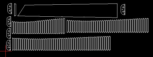

I've been fooling around with the script and this is how the fretboard will look like, kinda weird eh.
Screenshot 4.jpg (8.11 KiB) Viewed 64666 times
But I want to give it a try.
Hans

else:
  print 'no frets are drawn'
# drawing outline
## points
xoffset = 30
## lines
F1 = Part.Face(W1)
sdoffset = []
sdoffset.append(0)
  xtemp1 = -xoffset
  xtemp3 = xtemp2
  xtemp4 = -xoffset
  P2 = P2.cut(Ptemp)
if typefretboard == 0:
  P2 = P2.cut(Pcut[0])
else:
  for i in range(0,len(Pcut)+1):
Neck.Shape = P1
# Drawing the body
d2 = rkleineboog
yVb0 = 0
yVb1 = rgroteboog
xVb5 = rkleineboog
yVb5 = rkleineboog
xVb6 = rcutaway2
yVb6 = 2*rcutaway2
xVb7 = 2*rcutaway2
yVb7 = rcutaway2
xVb8 = rcutaway2
yVb8 = 0
xVb9 = 0
yVb9 = 0
xVb10 = xbass[len(xbass)-1]+20+lengthbody-xend
yVb10 = 0
xVbtrans = []
yVbtrans = []
Vpos = []
Vneg = []
  print xtemp
yVbtuner5 = 0
Vbtuner = []
## XLR input cut
rc2 = -1/rc1
Vbxlr = []
Lbxlr1 = Part.Line(Vbxlr[0],Vbxlr[1])
Lbxlr2 = Part.Line(Vbxlr[1],Vbxlr[2])
Lbxlr3 = Part.Line(Vbxlr[2],Vbxlr[3])
Lbxlr4 = Part.Line(Vbxlr[3],Vbxlr[0])
Bodybvnplaatxlrcut = Part.Shape([Lbxlr1,Lbxlr2,Lbxlr3,Lbxlr4])
WBodybvnplaatxlrcut = Part.Wire(Bodybvnplaatxlrcut.Edges)
FBodybvnplaatxlrcut = Part.Face(WBodybvnplaatxlrcut)
PBodybvnplaatxlrcut = FBodybvnplaatxlrcut.extrude(Base.Vector(0,0,thicknessbodyplate))
xtrans = -math.sqrt(transxlr**2/(rc1**2+1))
ytrans = math.sqrt(transxlr**2/((1/rc1**2)+1))
PBodybvnplaatxlrcut.translate(Base.Vector(xtrans,ytrans,0))
PBodybvnplaat = PBodybvnplaat.cut(PBodybvnplaatxlrcut)
## Alignment cutout and bolts
cylinderalignment = Part.makeCylinder(0.5*Alignmenthole,2.*thicknessbodyplate)
cylalig1 = cylinderalignment.copy()
cylalig2 = cylinderalignment.copy()
cylalig1.translate(Base.Vector(slbass-slbass/2**(numberfrets/octavedivider)+40.,-0.5*widthnut,-thicknessbodyplate))
cylalig2.translate(Base.Vector(slbass-slbass/2**(numberfrets/octavedivider)+40.,0.5*widthnut,-thicknessbodyplate))
PBodybvnplaat = PBodybvnplaat.cut(cylalig1)
PBodybvnplaat = PBodybvnplaat.cut(cylalig2)
# Maken van onderplaat body
Bodyndrplaat = Part.Shape([Apos1,Apos2,Apos3,Apos4,Lpos3,Lpos4,Lneg4,Aneg3,Aneg2,Aneg1,back])
WBodyndrplaat = Part.Wire(Bodyndrplaat.Edges)
FBodyndrplaat = Part.Face(WBodyndrplaat)
PBodyndrplaat = FBodyndrplaat.extrude(Base.Vector(0,0,-thicknessbodyplate))
PBodyndrplaatxlrcut = PBodybvnplaatxlrcut.copy()
PBodyndrplaatxlrcut.translate(Base.Vector(0,0,-thicknessbodyplate))
PBodyndrplaat = PBodyndrplaat.cut(PBodyndrplaatxlrcut)
PBodyndrplaat = PBodyndrplaat.cut(cylalig1)
PBodyndrplaat = PBodyndrplaat.cut(cylalig2)
cylindermountingbody = Part.makeCylinder(rneckbolts,thicknessbodyplate)
cylmbody1 = cylindermountingbody.copy()
cylmbody2 = cylindermountingbody.copy()
cylmbody3 = cylindermountingbody.copy()
cylmbody4 = cylindermountingbody.copy()
cylmbody1.translate(Base.Vector(slbass-slbass/2**(fretwherebodymeetsneck/octavedivider)+20.,0.4*widthnut,-thicknessbodyplate))
cylmbody2.translate(Base.Vector(slbass-slbass/2**(numberfrets/octavedivider)-20.,0.4*widthnut,-thicknessbodyplate))
cylmbody3.translate(Base.Vector(slbass-slbass/2**(fretwherebodymeetsneck/octavedivider)+20.,-0.4*widthnut,-thicknessbodyplate))
cylmbody4.translate(Base.Vector(slbass-slbass/2**(numberfrets/octavedivider)-20.,-0.4*widthnut,-thicknessbodyplate))
PBodyndrplaat = PBodyndrplaat.cut(cylmbody1)
PBodyndrplaat = PBodyndrplaat.cut(cylmbody2)
PBodyndrplaat = PBodyndrplaat.cut(cylmbody3)
PBodyndrplaat = PBodyndrplaat.cut(cylmbody4)
# single string bridge tekenen
doc=App.activeDocument()
grp=doc.addObject("App::DocumentObjectGroup", "SingleStringBridge")
xbridgetreble = sltreble + offsetnut
ybridgetreble = 0.5*widthnut + (widthbridge-widthnut)/2*((sltreble+offsetnut)/slbass)
rcbridge = (-0.5*widthbridge-ybridgetreble)/(slbass-xbridgetreble)
bbridge = ybridgetreble - rcbridge*(xbridgetreble-0)
lyintersect = []
lxintersect = []
Lbridge = []
  ynut = -widthnut/2.0 + sdside + sum(diastrtemp) - 0.5*diastr[i] + sum(sdnuttemp)
  ybridge = -widthbridge/2.0 + sdside + sum(diastrtemp) - 0.5*diastr[i] + sum(sdbridgetemp)
  rcstring = (ybridge-ynut)/(slbass-0.)
  xintersect = (ynut - bbridge)/(rcbridge-rcstring)
  yintersect = ynut + rcstring*xintersect
  lyintersect.append(yintersect)
  lxintersect.append(xintersect)
  bridge = Part.makeBox(bridgelength-bridgewidth, bridgewidth, thicknessbodyplate)
  bridgecyl1 = Part.makeCylinder(0.5*bridgewidth, thicknessbodyplate)
  bridgecyl2 = Part.makeCylinder(0.5*bridgewidth, thicknessbodyplate)
  bridgecyl3 = Part.makeCylinder(rbridgercylinder, thicknessbodyplate)
  bridgecyl1.translate(Base.Vector(0, 0.5*bridgewidth, 0))
  bridgecyl2.translate(Base.Vector(bridgelength-bridgewidth, 0.5*bridgewidth, 0))
  bridgecyl3.translate(Base.Vector(0.5*(bridgelength-bridgewidth), 0.5*bridgewidth, 0))
  bridge = bridge.fuse(bridgecyl1)
  bridge = bridge.fuse(bridgecyl2)
  bridge = bridge.cut(bridgecyl3)
  bridgemountinghole1 = Part.makeBox(10-2.*rbridgercylinder/0.8, 2.*rbridgercylinder/0.8, thicknessbodyplate)
  bridgecyl4 = Part.makeCylinder(rbridgercylinder/0.8,thicknessbodyplate)
  bridgecyl5 = Part.makeCylinder(rbridgercylinder/0.8,thicknessbodyplate)
  bridgecyl4.translate(Base.Vector(0,rbridgercylinder/0.8,0))
  bridgecyl5.translate(Base.Vector((10-2.*rbridgercylinder/0.8),rbridgercylinder/0.8,0))
  bridgemountinghole1 = bridgemountinghole1.fuse(bridgecyl4)
  bridgemountinghole1 = bridgemountinghole1.fuse(bridgecyl5)
  bridgemountinghole2 = bridgemountinghole1.copy()
  bridgemountinghole1.translate(Base.Vector(-0.5*(10-2.*rbridgercylinder/0.8),-rbridgercylinder/0.8,0))
  bridgemountinghole1.translate(Base.Vector(0.5*(bridgelength-bridgewidth)-10,0.5*bridgewidth,0))
  bridgemountinghole2.translate(Base.Vector(-0.5*(10-2.*rbridgercylinder/0.8),-rbridgercylinder/0.8,0))
  bridgemountinghole2.translate(Base.Vector(0.5*(bridgelength-bridgewidth)+10,0.5*bridgewidth,0))
  bridge = bridge.cut(bridgemountinghole1)
  bridge = bridge.cut(bridgemountinghole2)
  bridgefcutter = bridge.copy()
  Lbridge.append(bridgefcutter)
  bridge.translate(Base.Vector(-0.5*(bridgelength-bridgewidth),-0.5*bridgewidth,0))
  bridge.translate(Base.Vector(xintersect+compensation,yintersect,0))
  # displaying the bridge
  SingleStringBridge = FreeCAD.ActiveDocument.addObject("Part::Feature","SingleStringBridge")
  SingleStringBridge.Shape = bridge
  grp.addObject(SingleStringBridge)
  # drawing the cut from the bodyplate
  bridgecut = Part.makeBox(bridgelength+10-bridgewidth, bridgewidth, thicknessbodyplate)
  bridgecutcyl1 = Part.makeCylinder(0.5*bridgewidth, thicknessbodyplate)
  bridgecutcyl2 = Part.makeCylinder(0.5*bridgewidth, thicknessbodyplate)
  bridgecutcyl1.translate(Base.Vector(0, 0.5*bridgewidth, 0))
  bridgecutcyl2.translate(Base.Vector(bridgelength+10-bridgewidth, 0.5*bridgewidth, 0))
  bridgecut = bridgecut.fuse(bridgecutcyl1)
  bridgecut = bridgecut.fuse(bridgecutcyl2)
  bridgecut.translate(Base.Vector(-0.5*(bridgelength+10.-bridgewidth),-0.5*bridgewidth,0))
  bridgecut.translate(Base.Vector(xintersect+compensation,yintersect,0))
  PBodybvnplaat = PBodybvnplaat.cut(bridgecut)
  # cutting the holes for the SingleStringBridge
  bridgebodymountinghole1 = Part.makeCylinder(rbridgercylinder,thicknessbodyplate)
  bridgebodymountinghole2 = Part.makeCylinder(rbridgercylinder,thicknessbodyplate)
  bridgebodymountinghole1.translate(Base.Vector(xintersect+compensation-10,yintersect,-thicknessbodyplate))
  bridgebodymountinghole2.translate(Base.Vector(xintersect+compensation+10,yintersect,-thicknessbodyplate))
  PBodyndrplaat = PBodyndrplaat.cut(bridgebodymountinghole1)
  PBodyndrplaat = PBodyndrplaat.cut(bridgebodymountinghole2)
# drawing tuner mounting pieces and mounting holes
grp=doc.addObject("App::DocumentObjectGroup", "TunerMountingPiece")
tmountingpiecebass = Part.makeBox(tmountingpiecelength,tmountingpiecewidth,thicknessbodyplate) 	# these measurements are based on this specific tuners
tmountingpiecebasscyl1 = Part.makeCylinder(rbridgercylinder/0.8,thicknessbodyplate)
tmountingpiecebasscyl2 = tmountingpiecebasscyl1.copy()
tmountingpiecebasscyl1.translate(Base.Vector(3+rbridgercylinder/0.8,0.5*tmountingpiecewidth,0))
tmountingpiecebasscyl2.translate(Base.Vector(tmountingpiecelength-(3+rbridgercylinder/0.8),0.5*tmountingpiecewidth,0))
tmountingpiecebass = tmountingpiecebass.cut(tmountingpiecebasscyl1)
tmountingpiecebass = tmountingpiecebass.cut(tmountingpiecebasscyl2)
tmountingpiecetreble = tmountingpiecebass.copy()
tmountingpiecebasscyl3 = Part.makeCylinder(1, thicknessbodyplate)
tmountingpiecebasscyl3.translate(Base.Vector(tmountingpiecelength-tmountingpieceholefortuner,0,0))
tmountingpiecebass = tmountingpiecebass.cut(tmountingpiecebasscyl3)
tmountingpiecetreblecyl1 = Part.makeCylinder(1, thicknessbodyplate)
tmountingpiecetreblecyl1.translate(Base.Vector(tmountingpiecelength-tmountingpieceholefortuner,tmountingpiecewidth,0))
tmountingpiecetreble = tmountingpiecetreble.cut(tmountingpiecetreblecyl1)
## Drawing the mounting piece of the bassside
tmountingpiecebass1 = tmountingpiecebass.copy()
tmountingpiecebass1.translate(Base.Vector(lxintersect[0]+2.*offsetfrombridge-(tmountingpiecelength-tmountingpieceholefortuner),lyintersect[0]-24, 0))
TunerMountingPiece = FreeCAD.ActiveDocument.addObject("Part::Feature","TunerMountingPiece")
TunerMountingPiece.Shape = tmountingpiecebass1
grp.addObject(TunerMountingPiece)
tmountingpiecebass2 = tmountingpiecebass.copy()
tmountingpiecebass2.translate(Base.Vector(lxintersect[0]+2.*offsetfrombridge-(tmountingpiecelength-tmountingpieceholefortuner)+tmountingpiecelength,lyintersect[1]-24, 0))
TunerMountingPiece.Shape = tmountingpiecebass2
tmountingpiecebass3 = tmountingpiecebass.copy()
tmountingpiecebass3.translate(Base.Vector(lxintersect[0]+2.*offsetfrombridge-(tmountingpiecelength-tmountingpieceholefortuner)+2*tmountingpiecelength,lyintersect[2]-24, 0))
TunerMountingPiece.Shape = tmountingpiecebass3
## Drawing the mounting piece of the trebleside
tmountingpiecetreble1 = tmountingpiecetreble.copy()
tmountingpiecetreble1.translate(Base.Vector(lxintersect[6]+2.*offsetfrombridge-(tmountingpiecelength-tmountingpieceholefortuner),lyintersect[6]+24-tmountingpiecewidth, 0))
TunerMountingPiece.Shape = tmountingpiecetreble1
tmountingpiecetreble2 = tmountingpiecetreble.copy()
tmountingpiecetreble2.translate(Base.Vector(lxintersect[6]+2.*offsetfrombridge-(tmountingpiecelength-tmountingpieceholefortuner)+tmountingpiecelength,lyintersect[5]+24-tmountingpiecewidth, 0))
TunerMountingPiece.Shape = tmountingpiecetreble2
tmountingpiecetreble3 = tmountingpiecetreble.copy()
tmountingpiecetreble3.translate(Base.Vector(lxintersect[6]+2.*offsetfrombridge-(tmountingpiecelength-tmountingpieceholefortuner)+2*tmountingpiecelength,lyintersect[4]+24-tmountingpiecewidth, 0))
TunerMountingPiece.Shape = tmountingpiecetreble3
tmountingpiecetreble4 = tmountingpiecetreble.copy()
tmountingpiecetreble4.translate(Base.Vector(lxintersect[6]+2.*offsetfrombridge-(tmountingpiecelength-tmountingpieceholefortuner)+3*tmountingpiecelength,lyintersect[3]+24-tmountingpiecewidth, 0))
TunerMountingPiece.Shape = tmountingpiecetreble4
## Drawing cut for underplate
cuttmountingpiecebasscyl1 = Part.makeCylinder(rbridgercylinder,thicknessbodyplate)
cuttmountingpiecebasscyl2 = cuttmountingpiecebasscyl1.copy()
cuttmountingpiecebasscyl1.translate(Base.Vector(3+rbridgercylinder/0.8,0.5*tmountingpiecewidth,0))
cuttmountingpiecebasscyl2.translate(Base.Vector(tmountingpiecelength-(3+rbridgercylinder/0.8),0.5*tmountingpiecewidth,0))
cuttmountingpiecebass1cyl1 = cuttmountingpiecebasscyl1.copy()
cuttmountingpiecebass1cyl1.translate(Base.Vector(lxintersect[0]+2.*offsetfrombridge-(tmountingpiecelength-tmountingpieceholefortuner),lyintersect[0]-24, -thicknessneck))
PBodyndrplaat = PBodyndrplaat.cut(cuttmountingpiecebass1cyl1)
cuttmountingpiecebass1cyl2 = cuttmountingpiecebasscyl2.copy()
cuttmountingpiecebass1cyl2.translate(Base.Vector(lxintersect[0]+2.*offsetfrombridge-(tmountingpiecelength-tmountingpieceholefortuner),lyintersect[0]-24, -thicknessneck))
PBodyndrplaat = PBodyndrplaat.cut(cuttmountingpiecebass1cyl2)
cuttmountingpiecebass2cyl1 = cuttmountingpiecebasscyl1.copy()
cuttmountingpiecebass2cyl1.translate(Base.Vector(lxintersect[0]+2.*offsetfrombridge-(tmountingpiecelength-tmountingpieceholefortuner)+tmountingpiecelength,lyintersect[1]-24, -thicknessneck))
PBodyndrplaat = PBodyndrplaat.cut(cuttmountingpiecebass2cyl1)
cuttmountingpiecebass2cyl2 = cuttmountingpiecebasscyl2.copy()
cuttmountingpiecebass2cyl2.translate(Base.Vector(lxintersect[0]+2.*offsetfrombridge-(tmountingpiecelength-tmountingpieceholefortuner)+tmountingpiecelength,lyintersect[1]-24, -thicknessneck))
PBodyndrplaat = PBodyndrplaat.cut(cuttmountingpiecebass2cyl2)
cuttmountingpiecebass3cyl1 = cuttmountingpiecebasscyl1.copy()
cuttmountingpiecebass3cyl1.translate(Base.Vector(lxintersect[0]+2.*offsetfrombridge-(tmountingpiecelength-tmountingpieceholefortuner)+2*tmountingpiecelength,lyintersect[2]-24, -thicknessneck))
PBodyndrplaat = PBodyndrplaat.cut(cuttmountingpiecebass3cyl1)
cuttmountingpiecebass3cyl2 = cuttmountingpiecebasscyl2.copy()
cuttmountingpiecebass3cyl2.translate(Base.Vector(lxintersect[0]+2.*offsetfrombridge-(tmountingpiecelength-tmountingpieceholefortuner)+2*tmountingpiecelength,lyintersect[2]-24, -thicknessneck))
PBodyndrplaat = PBodyndrplaat.cut(cuttmountingpiecebass3cyl2)
cuttmountingpiecetreble1cyl1 = cuttmountingpiecebasscyl1.copy()
cuttmountingpiecetreble1cyl1.translate(Base.Vector(lxintersect[6]+2.*offsetfrombridge-(tmountingpiecelength-tmountingpieceholefortuner),lyintersect[6]+24-tmountingpiecewidth, -thicknessbodyplate))
PBodyndrplaat = PBodyndrplaat.cut(cuttmountingpiecetreble1cyl1)
cuttmountingpiecetreble1cyl2 = cuttmountingpiecebasscyl2.copy()
cuttmountingpiecetreble1cyl2.translate(Base.Vector(lxintersect[6]+2.*offsetfrombridge-(tmountingpiecelength-tmountingpieceholefortuner),lyintersect[6]+24-tmountingpiecewidth, -thicknessbodyplate))
PBodyndrplaat = PBodyndrplaat.cut(cuttmountingpiecetreble1cyl2)
cuttmountingpiecetreble2cyl1 = cuttmountingpiecebasscyl1.copy()
cuttmountingpiecetreble2cyl1.translate(Base.Vector(lxintersect[6]+2.*offsetfrombridge-(tmountingpiecelength-tmountingpieceholefortuner)+tmountingpiecelength,lyintersect[5]+24-tmountingpiecewidth, -thicknessbodyplate))
PBodyndrplaat = PBodyndrplaat.cut(cuttmountingpiecetreble2cyl1)
cuttmountingpiecetreble2cyl2 = cuttmountingpiecebasscyl2.copy()
cuttmountingpiecetreble2cyl2.translate(Base.Vector(lxintersect[6]+2.*offsetfrombridge-(tmountingpiecelength-tmountingpieceholefortuner)+tmountingpiecelength,lyintersect[5]+24-tmountingpiecewidth, -thicknessbodyplate))
PBodyndrplaat = PBodyndrplaat.cut(cuttmountingpiecetreble2cyl2)
cuttmountingpiecetreble3cyl1 = cuttmountingpiecebasscyl1.copy()
cuttmountingpiecetreble3cyl1.translate(Base.Vector(lxintersect[6]+2.*offsetfrombridge-(tmountingpiecelength-tmountingpieceholefortuner)+2.*tmountingpiecelength,lyintersect[4]+24-tmountingpiecewidth, -thicknessbodyplate))
PBodyndrplaat = PBodyndrplaat.cut(cuttmountingpiecetreble3cyl1)
cuttmountingpiecetreble3cyl2 = cuttmountingpiecebasscyl2.copy()
cuttmountingpiecetreble3cyl2.translate(Base.Vector(lxintersect[6]+2.*offsetfrombridge-(tmountingpiecelength-tmountingpieceholefortuner)+2.*tmountingpiecelength,lyintersect[4]+24-tmountingpiecewidth, -thicknessbodyplate))
PBodyndrplaat = PBodyndrplaat.cut(cuttmountingpiecetreble3cyl2)
cuttmountingpiecetreble4cyl1 = cuttmountingpiecebasscyl1.copy()
cuttmountingpiecetreble4cyl1.translate(Base.Vector(lxintersect[6]+2.*offsetfrombridge-(tmountingpiecelength-tmountingpieceholefortuner)+3.*tmountingpiecelength,lyintersect[3]+24-tmountingpiecewidth, -thicknessbodyplate))
PBodyndrplaat = PBodyndrplaat.cut(cuttmountingpiecetreble4cyl1)
cuttmountingpiecetreble4cyl2 = cuttmountingpiecebasscyl2.copy()
cuttmountingpiecetreble4cyl2.translate(Base.Vector(lxintersect[6]+2.*offsetfrombridge-(tmountingpiecelength-tmountingpieceholefortuner)+3.*tmountingpiecelength,lyintersect[3]+24-tmountingpiecewidth, -thicknessbodyplate))
PBodyndrplaat = PBodyndrplaat.cut(cuttmountingpiecetreble4cyl2)
# Drawing nut extension
endpieceV1 = Base.Vector(-xoffset,-yoffset,thfretboard)
endpieceV2 = Base.Vector(-xoffset,-yoffset,0)
endpieceV3 = Base.Vector(-xoffset,-yoffset+thicknessneck-thicknessneck/2**0.5,-thicknessneck/2**0.5)
endpieceV4 = Base.Vector(-xoffset,-yoffset+thicknessneck,-thicknessneck)
endpieceV5 = Base.Vector(-xoffset,yoffset-thicknessneck,-thicknessneck)
endpieceV6 = Base.Vector(-xoffset,yoffset-thicknessneck+thicknessneck/2**0.5,-thicknessneck/2**0.5)
endpieceV7 = Base.Vector(-xoffset,yoffset,0)
endpieceV8 = Base.Vector(-xoffset,yoffset,thfretboard)
endpieceL1 = Part.Line(endpieceV1,endpieceV2)
endpieceA1 = Part.Arc(endpieceV2,endpieceV3,endpieceV4)
endpieceL2 = Part.Line(endpieceV4,endpieceV5)
endpieceA2 = Part.Arc(endpieceV5,endpieceV6,endpieceV7)
endpieceL3 = Part.Line(endpieceV7,endpieceV8)
endpieceL4 = Part.Line(endpieceV8,endpieceV1)
endpiece = Part.Shape([endpieceL1,endpieceA1,endpieceL2,endpieceA2,endpieceL3,endpieceL4])
Wendpiece = Part.Wire(endpiece.Edges)
Fendpiece = Part.Face(Wendpiece)
Pendpiece = Fendpiece.extrude(Base.Vector(-thendpiece,0,0))
Pendpiece.translate(Base.Vector(0,0,thicknessneck))
## Drawing string holes

### Frets on a row
grp=doc.addObject("App::DocumentObjectGroup", "Frets for cutter")
    Fretdisplay = Pfret[0]
    Fretdisplay.rotate((0,0,0),(0,0,1),90)
    Fretdisplay.rotate((0,0,0),(0,1,0),-90)
    Fretdisplay.translate(Base.Vector(0*(thfretboard+heightfret+3),100,0))
    Fretnr = "Fret0"
    Fretfcutter = FreeCAD.ActiveDocument.addObject("Part::Feature",Fretnr)
    Fretfcutter.Shape = Fretdisplay
    grp.addObject(Fretfcutter)
else:
  for i in range(0,len(Pfret)+1):
    Fretdisplay = Pfret[i]
    Fretdisplay.translate(Base.Vector(i*(thfretboard+heightfret+3),100,0))
### jig for router
PJigrouter = Part.makeBox(800,120,thicknessneck)
PJigrouter.translate(Base.Vector(-100,-60,0))
PJigrouter = PJigrouter.cut(Pcutjigrouter)
PJigrouter.translate(Base.Vector(0,-300,0))
Jigrouter = FreeCAD.ActiveDocument.addObject("Part::Feature","Jigrouter")
Jigrouter.Shape = PJigrouter
### TunerMountingPiece + SingleStringBridge
for i in range(0,len(diastr)+1):
  Ptmountingpiecetreblefcutter = tmountingpiecetreble.copy()
  Ptmountingpiecetreblefcutter.translate(Base.Vector(i*(tmountingpiecelength+5.),250,0))
  tmountingpiecefcutter = FreeCAD.ActiveDocument.addObject("Part::Feature","TunerMountingPiece")
  tmountingpiecefcutter.Shape = Ptmountingpiecetreblefcutter
  Pbridgefcutter = Lbridge[0].copy()
  Pbridgefcutter.translate(Base.Vector(i*(bridgelength+5.),300,0))
  bridgefcutter = FreeCAD.ActiveDocument.addObject("Part::Feature","SingleStringBridge")
  bridgefcutter.Shape = Pbridgefcutter
Gui.SendMsgToActiveView("ViewFit")

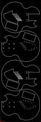

I've been nesting the parts.
This week I will do a software dry run. I will load the drawings in the cutter software and it will check if there are errors or ambiguities in the drawing.
Birch plate 1.jpeg (16.38 KiB) Viewed 64621 times

I've been to the waterjetcutter twice now and most of the parts are now cut.
I've made a short clip of the cutter in action.
I've come to the point that the actual building starts, a good moment to evaluate the process so far.
Making the script and 3D drawings
As mentioned before I created my drawings by using a script. Making this script was a rather time consuming, typical trail and error process, where I had to learn to understand how the CAD-program works, learning the syntax of the programming language and dusting of my mathematical skills. I think it took about 100 hours to get the script at the point where it stands now.
Was it worth the effort?
Yes.
Because I have to tell the CAD-program where to draw what, I've learned a lot of the (history of the) geometry of a stringed instrument.
Second, the script -although still under development- makes it easy to draw new prototypes when needed, without starting from the ground up.
Third, I had time to fine tune my ideas and concepts before creating sawdust.
Offcourse there are a lot of things I would like to do better / different:
First, my script is a complete joke when it comes to programming etiquettes, so there is a lot to gain
Second, I would like to refine my body design, especially the bridge-end of the body is flat and it would be nicer if this would be a ellipse shape.
The use of the watercutter
In theory, one of the big advantages is that the cutter can cut out complex parts. This saves a lot of time.
In practice this didn't really turned out this way. We encountered a lot of trouble with the cutter's software, which freezed up every now and then, without any error message, so we couldn't do anything but to restart the process. Although it was easy to get to the point where the cutter stopped, rebooting the computer and setting up the software was time consuming.
Also the software may have a bug, several times the cutter did something different then in the dry run (cutting out parts, which needed to stay attached, or vice versa).
Another issue is that small parts can't be cut loose because they will fall in the water, so they are "undercut" which means that are cut out till 1 mm is left. This makes it necessary to file of sand the parts.
Because of the issues with the software, the plywood made longer contact with the water then expected, this resulted in some cracks between layers, which need some reglueing.
Last, the cutter uses sand as an abrasive, which clutters a little bit in the pores of the wood. This was solved by attaching a small waterhose besides the cuttershead.
Again, was it worth the efford?
With the software issues resolved and using waterresistance plywood for the next time, I think yes when making one of prototypes or making templates for a series of guitar.

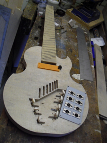

Building!
Finally I'm ready to start building / assembling the Quintar.
I will build one at a time. My pace will be slow, but steady. I don't intend to make it before the deadline but I don't mind, this challenge have been a good kickstarter.
A first mock up of what I have so far. Although I don't care much for soccer, the 3D-printed magnetholder is a nice link to Dutch team. ;)

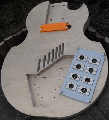

I've glued up the body and drilled the holes for the wires.
I placed magnets in the holder. I also mounted the connectors on the plate. And finally made a quick mock up.

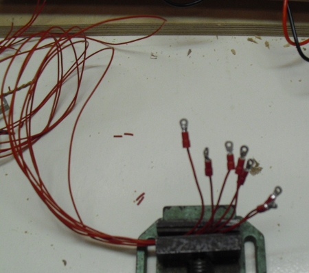

I also potted the current transformers, with my state-of-the-art potting equipment. ;)
Potting the current transformer.JPG (132.43 KiB) Viewed 63964 times
I hope to solder them to the xlr-connectors the next time. I presoldered the wires (pardon the blurry picture).
