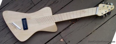

I made this fanned fret lap steel a while back. I play left handed with the bass string away from me. So I got the advantage of a longer base string and a more comfortable wrist position. Works great for me, and no one tries to borrow it.
Re: would fanned-fret spacing benefit a dulcimer or small guitar
How 'bout that! You're one of those southpaws who learned to do a workaround on a righty instrument. So, with the fanned frets, you can just pivot the elbow of your bar hand to follow the splay of the frets, huh? Cool!
