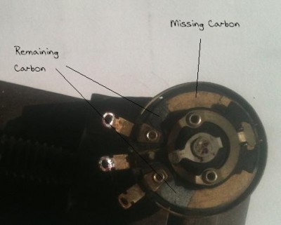

- Posts: 469
Re: '30s Epiphone Electar Archtop wiring diagram -- need one
Here is the second discovery which is way cool. This pot is the same as the first but it has been modified to be a three position switch. You can see that the carbon strip has been removed from the middle of the rotation of the pot. Lugs 1 and 3 of the pot are not connected via what was a 250K strip of carbon and the is only continuity between 1 and 2 at the max rotation CW, and 2 and 3 at the max rotation CCW. There is no connection what so ever in the mid position. I can't show it in the photo clearly enough but the missing carbon was clearly done on purpose. The part# and everything visible on the exterior of the pot is exactly the same between R1 and R2. This pot was in the R1 position of the diagram I drew earlier
I can't see any reason to remove the carbon from any part of a pot that would in this case make it an on off switch. More likely a earlier clueless cleaning. replace it with a new one. Replace the caps to. I had a 0.01 ceramic in my 64 Jazz bass that checked ok but turned over time onto a piezo. You could sing into the bass and it would act like a microphone, feedback was awful.
- Posts: 469
What is ubber convienient with this guitar is the back access cover. I can take the chance of installing all of the existing parts and easily remove them unlike your average archtop. I am a fan of using modern parts but my client is of the other persuasion to an extreme almost fanatical measure. The budget is generous with this one so I do the best that I can to make the client happy. If I can somehow use the existing parts, I will get a bonus next Christmas -- maybe custom mail order steaks like last year.
The pots did not look tampered with but then again, all reassembled, they don't look tampered with now.

- Posts: 469
Daryl, You were right on the money. I opened up the third pot and what I found was an example of what you describe as being a botched attempt at cleaning the pot that is about half way as tidy as what I thought was something way cool. I've ordered all new pots. I found Antique Electronics had pot from PEC that sort of looks similar on the exterior at not silly money like Alessandro. The client will appreciate the look.
