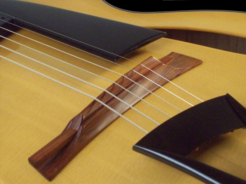

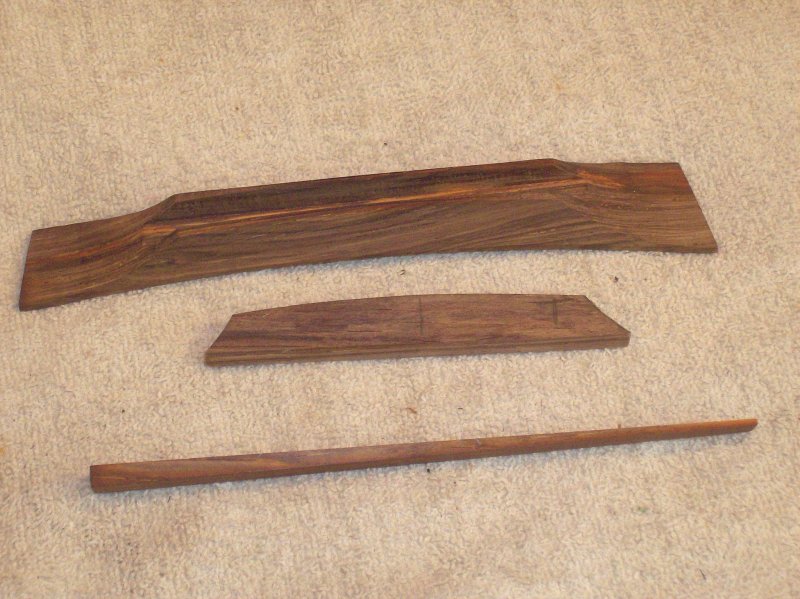

I've only ever made one. It was ok .... kind of a pain to adjust.
I won't get into dimensions ... you can figure that out. My suggestion is to start with the slot in the base (and milling stock for upper bits to fit the slot). Layout, cut & smooth the wedge surfaces, then shape everything.
