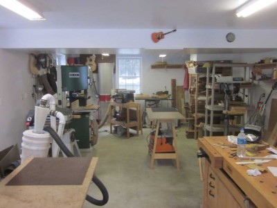

The pictures below show a 15x30 foot shop set up close to what you want. I pull in a spray box with a fan when I spray. I built 8 instruments in there last year. It would have been a couple more but I traveled a lot. Before this, most of my shop was in a 14x24 garage. I controlled the humidity in one small room in the house for glue ups and storage. I thought that this shop would be humongous when I had it built in 2006. At that time, I had no plans for a lathe or for the large bandsaw (I did have a 14"). Now, I wish I had made it larger. I would like more humidity controlled lumber storage (it's now outside in a shed). I would like more storage for instruments in the stages of construction. I'm sure that I could optimize it better. If I had another space where I could make dust, I would put the table saw there because I use it infrequently and don't need humidity control for it (I could put the lathe out, too). I set up the router table when I need it. I'm sure that whatever you build, it will eventually be too small. Good luck.

And here's another thought: I would be much happier with the space if it had a ten foot ceiling. I'm stuck at just under 8 feet because this was in the basement of a large addition to my house. A 10 foot ceiling would solve many of my storage issues. And, an attic or second story over that would be even greater.

I like high shelves, high cabinets, and lofts. It's storage without taking floor space. You can hang the lights from the bottom of the cabinets. Unless you're willing to build a sphere, a cube holds the most volume with the least surface area.
Regarding dehumidifying, I specified a plastic vapor barrier under the slab. When the concrete was being poured, I caught one of the workers slashing my plastic. I shouted "what are you doing?" He said he was letting the water out. The dehumidifier has run a lot more than I want it to. Against advice, I have left the concrete bare as a floor. It has worked out very well. It is easy to clean and hard to damage. If I could come up with a moisture barrier coating that would make a good floor surface, I would use it. So far, I haven't found anything I like.

Yikes! I never posted the pictures.

Re: Shop size?
Post by Bob Gramann »
Yikes! I never posted the pictures. One more thing to add: behind the shelves, where you can't see it, is a regular utility sink. It's very useful.

Bob. Nice looking shop.
You're right. A sink in the shop would be invaluable. I have a basin and I have to carry bottles of water to fill it.
You're lucky to have a dedicated space. As I said, mine is in my garage and I have to park my vehicles there also.
