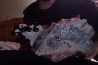

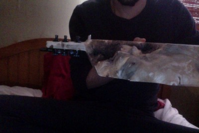

Hows it going everybody,
This last week, I started a project of mine, to turn a slab of buckeye burl into a lap steel guitar. When I was installing the machine heads, I had to start making cuts. I fashioned a headstock out of the solid slab of wood. The thickness of the headstock comes in at .645 inches, and the rest of the body is 2.5 inches thick.
My concern is that the buckeye doesn't seem too dense, it's not punky, but I'm beginning to fear that once I string it up the headstock will snap. Short of installing brackets on the area under the headstock and the body, what can i do to prevent this? I plan on applying several coats of polyurethane, which I know has hardening qualities, but I'm also looking into using miniwax wood hardener. Can i apply the wood hardener and afterwards apply a layer of polyurethane?
Any advice is appreciated!

now that is one interesting piece of wood. Looks like Marble from the pictures
