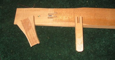

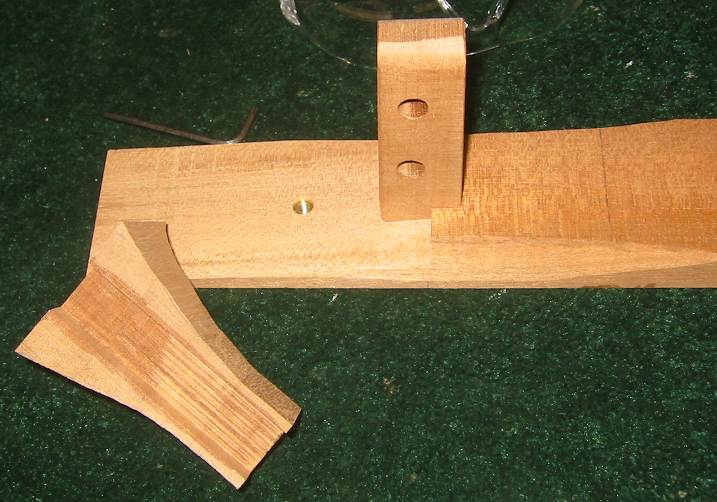

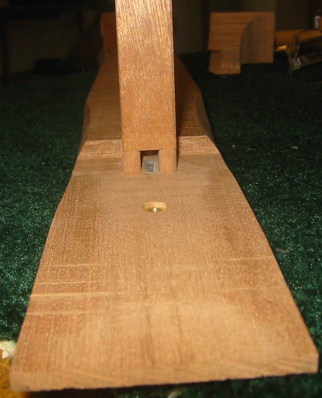

- Posts: 1182
Re: Intregral Neck Extension And The One Piece Archtop Guitar Neck.
So, this is how I did what you are talking about, but for a flat-top guitar. I built about 3 or 4 this way.
It has a continuous FB extension, with a mortise and tenon joint at the body.
I used a CNC mill to make the tenon joint to the neckshaft. It's all fit perfectly and generates an amazingly strong structure in the end, but it is a lot of work.
