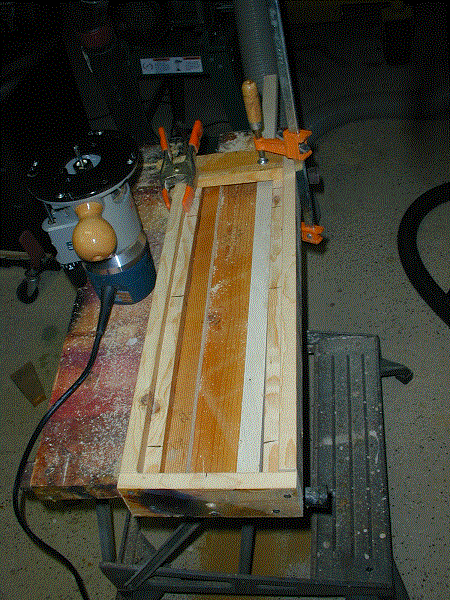

@ Warren - Do you by chance have a picture of how you have your workmate set up for a neck? I found this pic below (came off of google images but from mylespaul so I imagine its a neck of some sort). Looks like it would be good for a neck for sure. I do plan on getting a router table for bodies eventually.

I see that you have already cut your neck profile out so this is a little late, but you will find it much easier to route the truss rod channel on a blank of wood that has parallel sides and cut the profile out afterward. It would also be easier to thickness the wood if you have some extra bits on which to clamp the wood down - if you plan on using a router anyway.
Just my two cents. Looking forward to see how it all turns out.

Keith VanDen Heuvel wrote:I see that you have already cut your neck profile out so this is a little late, but you will find it much easier to route the truss rod channel on a blank of wood that has parallel sides and cut the profile out afterward. It would also be easier to thickness the wood if you have some extra bits on which to clamp the wood down - if you plan on using a router anyway.
You know, I never thought of that. I have more wood laying around, but the thought of cutting another neck out with a jigsaw makes me want to puke :lol: . Cutting that Walnut is hard on the ole elbows and wrists. I will keep that in mind when I build necks in the future.

As Keith said, it might be easier to cut the truss rod channel first. But you can still do it with the blank you have. You can make a special jig easily enough and use wedges with double sided tape to mount the neck. My picture isn't very clear but it's basically a box built out of scraps. The router runs on 2 rails that have the curvature of the truss rod for mounting from the rear of the neck. Stops keep it going the correct distance from the heel and headstock. I use a quarter inch bit and several passes. Hardest part is lining up the holes from the headstock to the channel. Simple but effective and cheap to build out of scraps.
