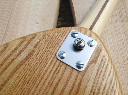

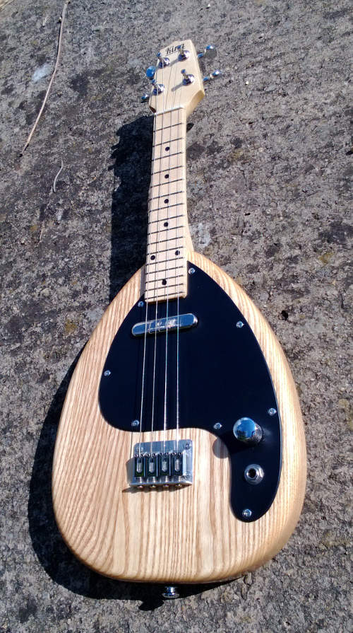

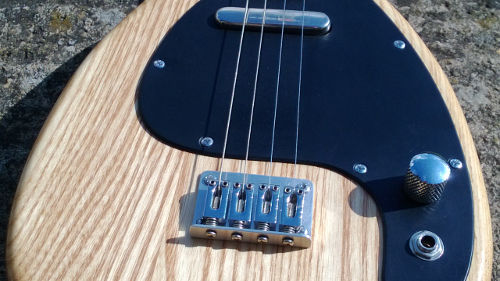

It was nice to be asked to make an Electric Ukulele again, not made one for years! My normal day job is making Lyres, harps and Kanteles so this is a nice relief, The neck was made around 2003 from my original batch and has a standard martin soprano scale( I normally use Stewmac mandolin fingerboards these days).
Body is 23cm wide, 40mm deep.
English Ash for the body, 4 piece, maple neck with walnut stripe. Telecaster pickup, single volume. The bridge was made from aluminium section, pick guard 2mm black plastic, No truss rod as such on these, I insert a carbon rod on the tenor neck version but not on this one, doesn't need it! I have some videos now on youtube to demonstrate this instrument, not sure If I can post them here, I also have a short simple one from my customer?
I have some in progress shots and will get around to writing up the construction blog soon on my website.

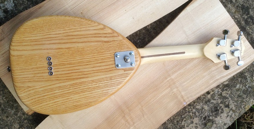

Nearly forgot the back shot, I used string through ferrules on this one.

Tru-oil body finish on the ash and neck with the body grain filled with Rustins oak grain filler before sanding and oil fnishing.

Very nice work. Please tell us about the pick up.

Most of the parts for this were bought from Stewmac 8 years ago, So the telecaster pickup is from them, It had been in a drawer and was scratched quite a bit but this was made quickly on a budget for someone. I shielded the cavities with copper foil tape and the pick-guard too making sure the pickup cover was grounded to the pot and not touching the other shielding.
