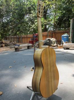

Agree, 100% Domestic!!! There are plenty of woods domestically to make fine string instrument, guitars. A man's domestic is another 's exotic. Tropical woods offer fine choices and veriety but theirs popularity is due to the ability to supply manufactures with large quantity as demanded, and cheap. Thinking of cutting down one acre of forest to get to one tree makes me sick. Here my latest 100% domestic. Fine wood, sounds excellent.
Bay Laurel back/side/neck/bindings (backyard downed tree)
W Red Cedar top (1 by8 fence boardfrom Orchard Supply Hardware)
Olive Rosette/Headstock
Persimmon fretboard/bridge
