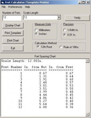

The scale length for a guitar with a 5.5" neck will depend on where exaclty the bridge is placed, but probably will be somewhere in the neighborhood of 11 to 13 inches - very much in the same ballpark as the scale length of a soprano ukelele, as mentioned by Jason. Here is a chart of fret positions for a 12" scale (screen shot of WFret - click on it to see it larger):

Jon gave a lot more info (and said it better) about what I was trying to say. Your scale length will determine your fret location. Do as Jon says and download wfret, it is one of the most important tools you will use as you get into this craft. Not only will Wfret calculate the measurements for you (lots of programs do that) but it will allow you to print out an actual size template of the fret locations (some printer adjusting may be needed so measure your print out and compare to the measurements given). If fret placement is indeed new to you, spend some time reading and asking questions here until it makes sense. Then start reading about compensation and intonation. With a scale length that short, you will have to make some adjustments. MIMF can help you there too, but you will have to know what type of strings you intend to use and have an idea of the tuning range you want.
