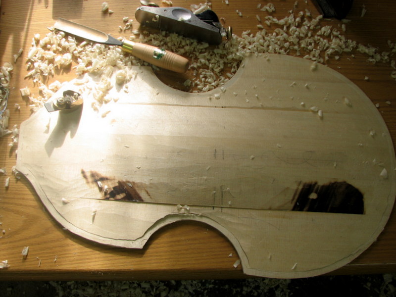

I am carving my first bent stave viol table now. I have the surface carved and mostly refined, ready for purfling. It was actually much easier to do than I had anticipated! Actually, quite easy to carve as the shape was basically determined.
Soon I will have to carve the back side and establish the thicknesses. That part has not much information available.

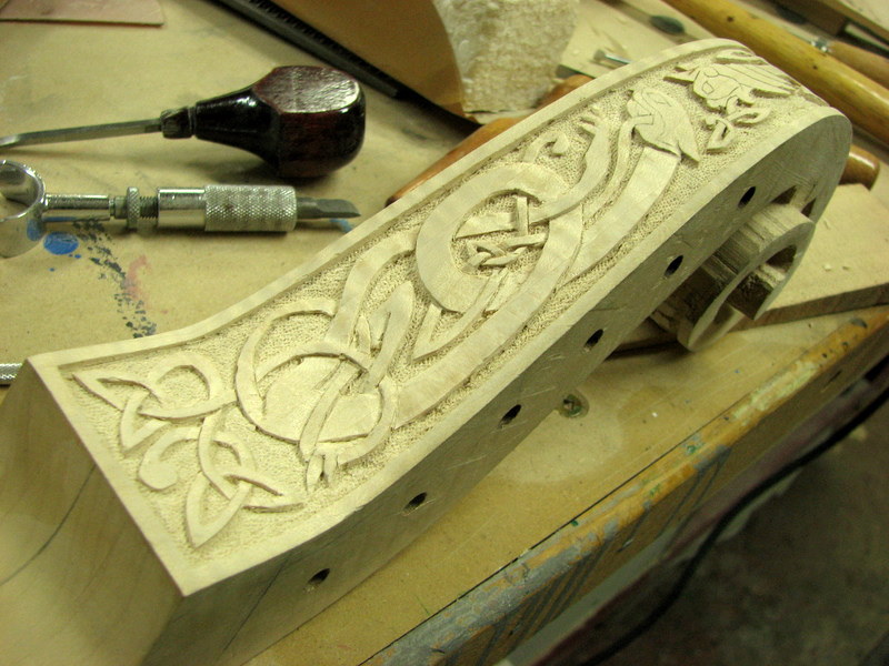

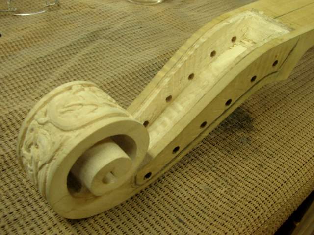

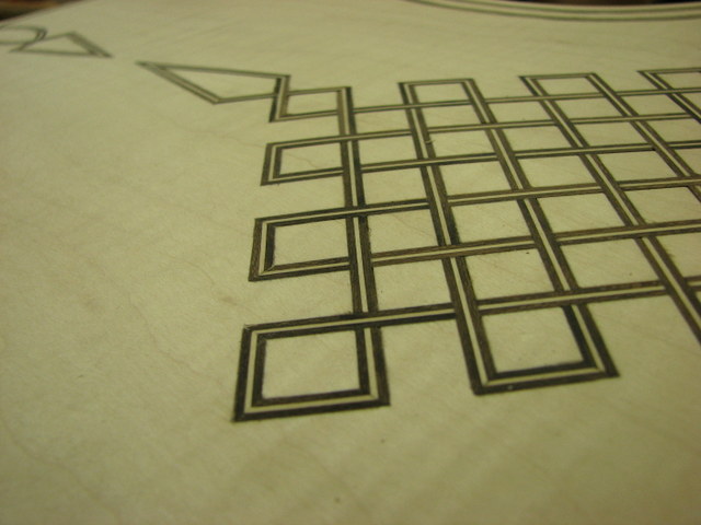

Any photos of your work? Would love to see. Here are a few of mine. The scroll photo is from before I finished it.

Chet, I had some celtic cat drawings which I adapted to the space. Don't worry, there isn't much perfection here! I don't fuss too much about perfect, I just try and do my best.

As you can see, I favoured a fairly plain style with double purfling. I truly admire your tenacity with the purfling patterns - love is a wonderful thing (Mrs J is still waiting for her virginalls). I did persevere once for a copy of the A&H Amati viola in the Ashmolean museum. Here's a scan from a photo I took before giving it to my customer.

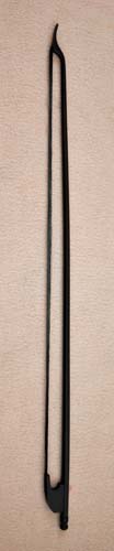

Since you mentioned bows, it's not too difficult to make a serviceable one. This is made from partridgewood and has a screwed frog. Bows seem to need to be as stiff as possible which means using dense wood. Snakewood is favoured but I reckon any fine grained timber with a specific gravity greater than 1 will do. Planing the wood was difficult and I ended up sanding mine on a shooting board. I had a look at a few professional makers sites to get an idea of the finished length and weight. It's not a great looking bow but it works well enough for me (who can't play the viol).

Bent the front purflings today. They are wider than standard to get a bold look. Now I can score and incise the trough for them.
