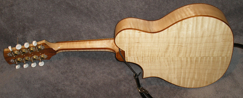

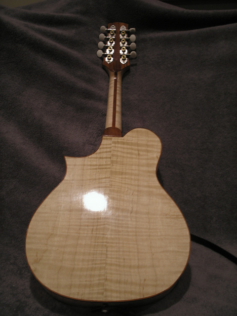

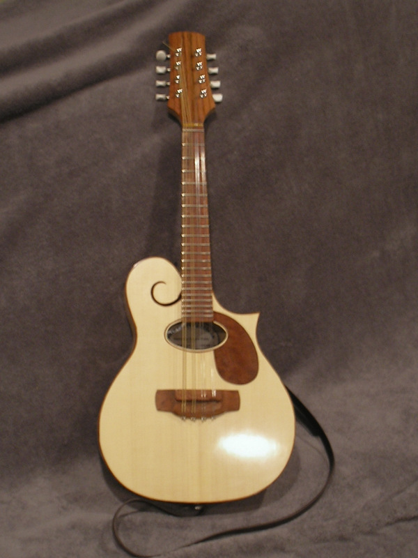

A while back I got some advice here about a fixed bridge mandolin. Thanks all! I am mostly finished with it now and figured I show a few pictures (and that I need a better camera and photography lessons).
This is made from mostly scrounged/free woods.
Engleman spruce top (Clay Schaffer sent me some veneers and used a cut up sound board to protect them that was just big enough for this project)
Spruce bracing
Curly maple back, sides and neck (rescued from the Home Depot stack)
Jatoba for just about everything else
Osage orange nut
French polish though I haven't buffed it up yet
I'm still playing around with saddle material, currently it has a hardwood saddle with a thin bone cap. I intend to try different woods to see what effect they may have.
Spruce bracing
Osage orange nut

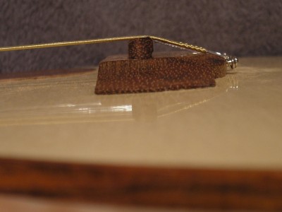

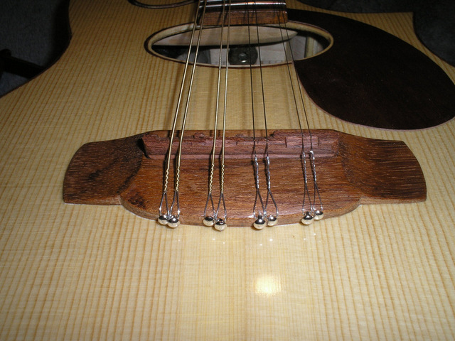

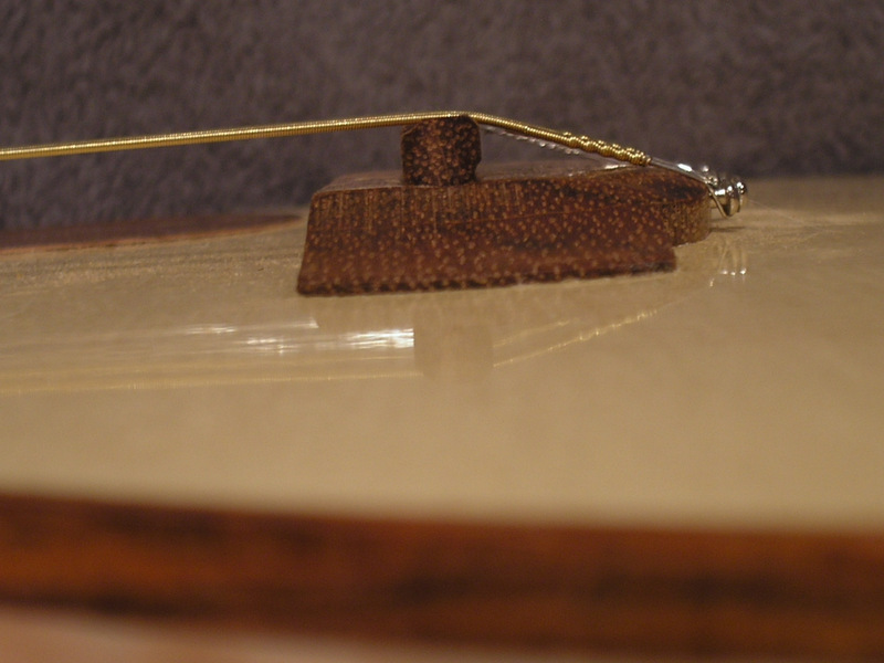

Here are a few shots of the bridge with an all jatoba saddle. The strings attach to some small stainless steel pins I had in the shop. I relieved the heads on the sides that face their partners to allow the strings to go on and off more easily.
Even with the glued bridge, I was able to get sufficient break angle and string height over the top. The saddle is 1/4 inch but could have been a bit thinner and still allowed for intonation. I erred on the side of caution and went with a foot print that was fairly large; I was worried that I would need the extra glue surface area. Now that it is all together, I feel I could have gotten away with a smaller footprint (but that would have been purely for aesthetics).

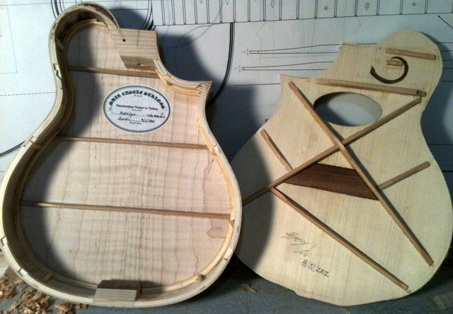

The bracing is nothing fancy, just shy of 1/4 inch (6mm) thick and 1/2 tall at the x and tapered down. The bridge plate is very thin African mahogany that happened to be handy. I put in two little cross grain patches to protect the curly-cue sound hole form breaking off.

Thans guys! And a special thanks to Mario for the help. I had the bracing plan in my head but had some whispers in my ear that made me second guess myself. I knew he had made a simmer animal for one of the challenges so I contacted him. He provided reassurance that my plan was not underbraced. In addition, he offered up some advise about attacking the bridge that certainly saved me some heartache. It really is nice when a pro takes the time to help out a newbie/hobbiest.

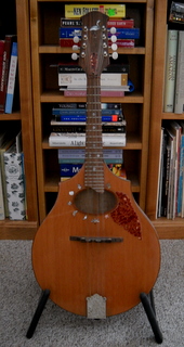

Bryan, I think you may have solved a major headache for me. I built this mando out of scrap and reject materials for my daughter and I employed an arch top neck angle and bridge. Not long after i strung it up I noticed the string tension starting to collapse the top. I wondered how a glued on bridge would do instead. I see you have done it!! Your instrument is gorgeous and I love it's shape! I was hoping for a bouzouki sound with bass and sustain, which I achieved, I was wondering how yours sounded.
I am inspired since to try your way, this instrument suffered a crack in the top do to a friend dropping it and I havent addressed the repairing or correcting in 4 years.
thanks!
thanks!

David, Nice looking mando! I’m not too sure this will be an option for you at this point, but I’ll offer some points to consider. When I was designing this, I had to determine a fretboard thickness that would work with my planned upper bout dome angle (which dictates the neck angle) to give me the desired height over the soundboard, acceptable saddle height and allow for adequate break angle behind the saddle. I didn’t want to change the neck angle so the other measurements were my variables and I was able to shift them around until all were in the range I wanted. Mario gave me some timely advice to make sure I had strings on hand to design in enough space for the windings behind the saddle.
If your bracing is deforming under the downward pressure of a floating bridge and tailpiece design, I would be very worried about the torque applied by a glued bridge. How is your top braced?
I doubt that your current neck angle will be in the range it would need to be. A neck angle as high as yours probably is would require a tall saddle (raising the strings high above the soundboard) that is going to really increase the torque applied.
If by fixing the top you mean you intend to retop it, then you may be able to brace accordingly (but likely still want to change your neck angle). If you do a bridge similar to mine, I have some things I would have done differently. Taking the loop ends off is a bit tricky without dinging the top behind the bridge. If I do this again I will either 1) shift everything forward a bit (bringing the saddle closer to the front of the bridge) and use some of that extra footprint to keep some wood behind the pins or 2) make the bridge blank thicker (taller), move the pins inside the bridge foot print and do more carving to reduce the weight.

Hi Bryan, thanks for the reply. So this instrument is braced very similar to yours in that it was braced like a guitar with maybe 2 lower tone bars(couldn't find the pics from way back). The bridge sets directly over a maple plate much like on a guitar. I'll tell you, it was made on the fly as just a camp fire/out door instrument, it just got fancy as it progressed. I just couldnt say no to my little girl at the time as she requested more art on it. In fact she designed the sound hole as a charm bracelet...I dont think I want to remove the top...ever LOL!
The bridge/saddle is not that much higher than yours is by comparison and what if I extend the lower part of the bridge with some sort of design feature? I may have the lift up torque problem under control maybe with out sacrificing too much sound quality? I do see your point though with the neck angle.

I completely understand, don't get rid of that top! I just measured, my strings are 3/8" above the soundboard. I was aiming for 1/2 or a little less. Can your neck angle get you in the half inch range? You will definately want to make sure you can get the bridge wings over the X legs. If you can't remember where they are, I have had luck mathing up two reare earch magnets (one on the inside and one on the outside) and moving the top one around to allow me to feel and mark the brace locations on the top (cover with masking tape first).
One thing I had to work out was how to set the compensation for each string. If your's intonates well, take careful measurements of the lenght of each course before you take the strings off <g>
