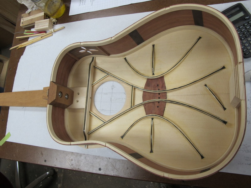

Re: soundhole patch
I did a soundhole patch on my current project where I have modified Trevor Gore's plans for a falcate-braced top to fit on a dred. I like the the way the patch locks everything together and also backs up the rosette like Alan said. I will probably use it in the future on X-braced tops as well.
