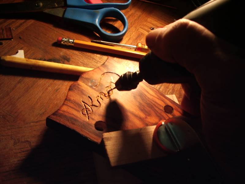

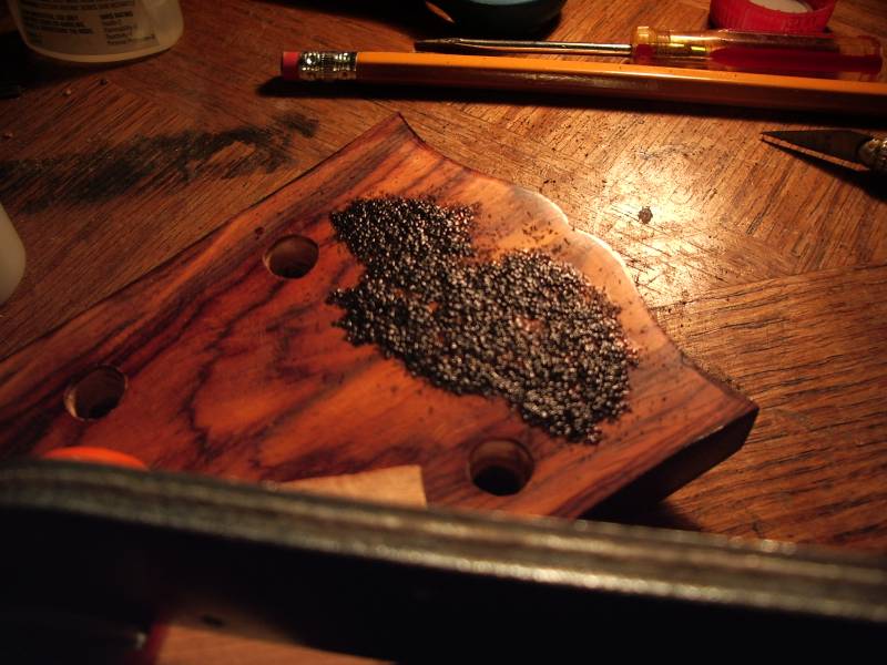

Have you tried packing the powder in dry and flooding with thin CA?
Overfill the pocket and then scrape it back.

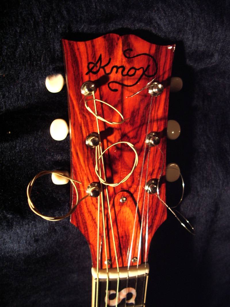

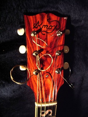

And the final result.
