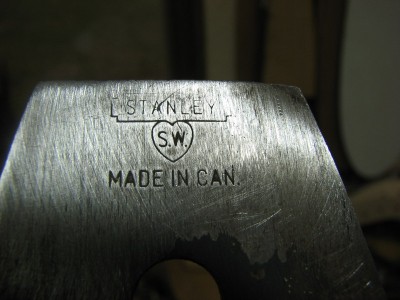

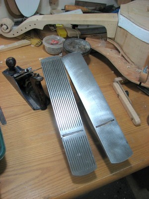

Meanwhile, a few photos of the plane in question. Both of these are "Sweetheart" with "Made in Canada" below the SW logo. I inherited the 5 1/2C from my father in law, but I bought the 5 1/2 a week and a half ago for $8. I would have paid the full $10 asking price but I made an offer and it was accepted.

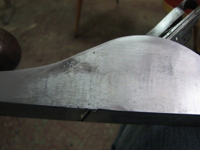

The 5 1/2 in the background and a 5 1/2C in the fore, which I just finished cleaning up and welding a nasty crack in the bed.
The plane in question, with a block plane for scale.

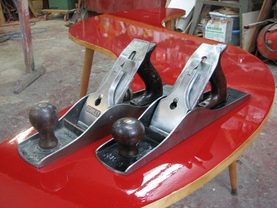

A few more photos of the completed 5 1/2C. So, now I have two of these!
The C was pretty much a basket case, cracked bed, rust, paint splatters all over, etc. My intention was not to make a totally prissied up plane but to get working planes that look decent.

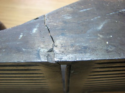

In addition to welding the crack ( not perfectly-my dad did it) I cleaned up the paint splatters and repainted the bed, other than that it was basically cleaning the metal and sharpening the blade. And replacing the front handle machine screw! Thanks to the wonders of the internet and the luthiers community, I now have a replacement screw making its way to me. Thanks to everyone who helped on my quest!
Both planes.
Both planes.
The "Sweetheart"
The "Sweetheart"
The 5 1/2 C on the left, the regular 5 1/2 on the right.
The cleaned up weld.  Not perfect, my dad did the welding.  Much better than broken!
The crack
The crack
