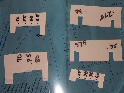

I made some gauges for measuring brace height (and thickness) out of plastic. They work, and are not expensive. You use them by feeling which slot the brace slips under.
