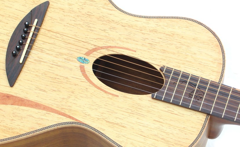

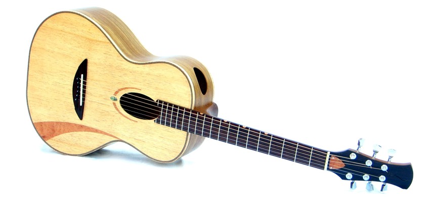

Number 3 of my "African Big 5", here are some pics of the new "lion".
Made almost entirely of African woods, kiaat back/sides with blonde mahogany soundboard.
I'm not too keen on the way the blonde top looks but am more than happy with the performance
Unusually, I used a lattice bracing which has worked a treat.
I have also made a short video which I will upload soon.

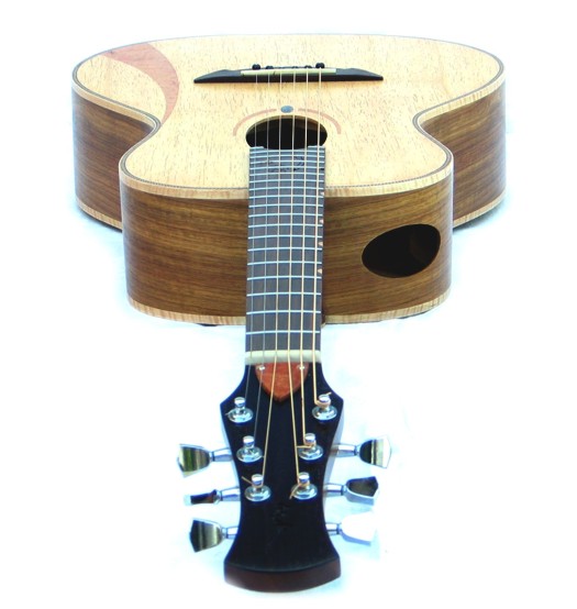

Post by Murray Kuun »
Front view

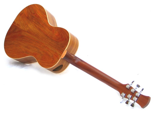

The back.

It is beautiful, I like the look of it very much. I have nothing to say that is critical, but I do wonder about one thing. Where and how do you draw the line between a pretty feature, and the functionality of a guitar? In other words, that "swoop" in the top takes a piece right out of it, and adds a couple of glue joints and a piece of wood that may take away from the tops' ability to work as well as it should. I think it is possible to add so many artistic elements to a guitar that some of them begin to impose upon its ability to perform as well as it might.

Fair point Mark and I gave it an enormous amount of thought and I have done this before (on the Leopard) and I did not feel it impaired sonic performance then (which is my first priority always). In fact, this lion is very definitely the best sounding steel string I have made (to my ears). The glue joint is painstakingly done and there is also some support from the lattice.
So, I don't believe it affects the tone negatively (I wonder if it has a positive effect?). But time will tell, this feature may not have the longevity I hope for:-)
At the end of the day, I just wanted to do it :-)
A close up pic of the "rosette" area and the subtle "lion" on the FB.

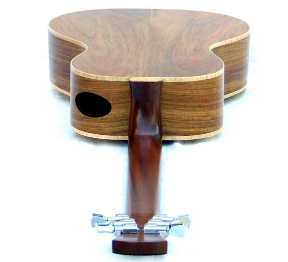

And another view of the back and heel/neck. The kiaat is not quite as red as the photo suggests.
