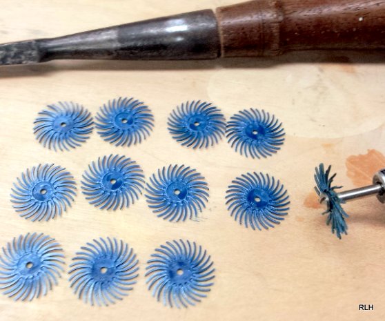

Also, while browsing the store I found 3M Radial Bristle abrasive discs that look very promising for cleaning and polishing. For an initial tryout, I bought the middle-grade blue 400 grit discs and tried them out on the socket of an old chisel (the brighter spot nearer the handle). They produce a smooth satin finish, and I expect that the finer grits should produce a bright polish. I have mislaid my thin draftsmans eraser shield that I use to protect fingerboards, but as soon as I find it (just after I buy another one), then I'll try them out on a fret.
