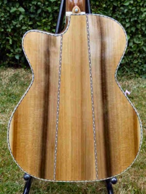

This OM sized instrument was my first attempt at making an acoustic guitar. As a complete novice, I found the tulip poplar sides really easy to bend. The dark lines in the back and sides were much softer than the surrounding lighter wood and I had to be really careful not to sand them too deep. It was finished with french polish and has retained it's colouring very well. Using tulip poplar I have ended up with a guitar that is very light in weight.

Show some more pictures.
Nice use of your narrow pieces.

OK Steve, here are some more pictures of my guitar.
First the front.
David Wilson
Posts: 5
Joined: Tue Jan 17, 2012 12:22 pm
Re: Tulip Poplar?
Post by David Wilson »
Now the back full length.
