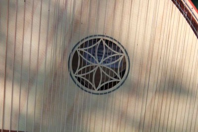

In a way, he did help build it! For that sound hole thing (what do you call those anyway?) I really wanted to have that delicate look to it but couldn't figure out a way to buff it out after finishing as the thingies are so thin. We're driving home from grandma and grandpa's place a couple months ago and I'm discussing it with either him or my wife (not that she wants to listen but I babble on anyway) and he suggests "why don't you finish it first, then buff it and then cut out the design?".....brilliant!
Doing so added a lot of other considerations as I usually glue on the bridge after finishing and with this design I can't get a clamp through the sound hole so I had to glue the bridge on before I glued the top down. The end result is that it was quite hard to get the finish buffed well around the bridge...but, it is a kid's instrument so I'm not too concerned about it.
