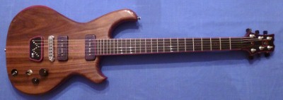

Here is my tenth guitar built for a talented young musician as a college graduation gift. Walnut/maple/purpleheart neck with walnut/maple/purpleheart/mahogany body wings. Fingerboard and headstock overlay are ebony bound with purpleheart. Pickups are Stew-Mac P90s. After using true oil on my two previous guitars, I tried Waterlox. It was more difficult to apply, and I am not totally happy with the results.

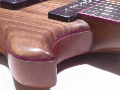

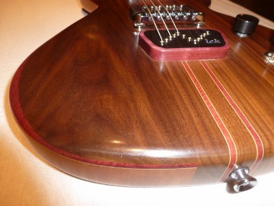

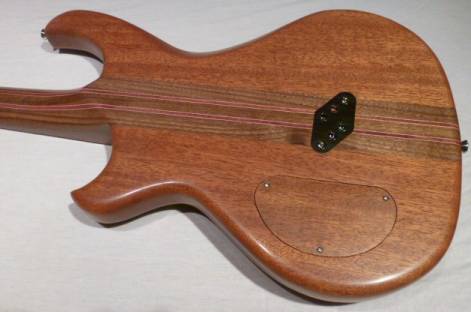

Here are some more photos. Pickup covers are flamed maple dyed black. Ebony inlay on back is to cover a hole drilling tear-out.

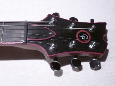

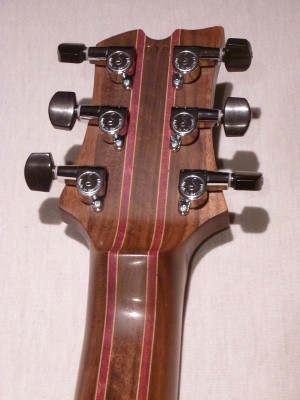

And the headstock.
Headstock back.jpg (47.04 KiB) Viewed 13998 times
Headstock front.jpg (41.84 KiB) Viewed 13998 times

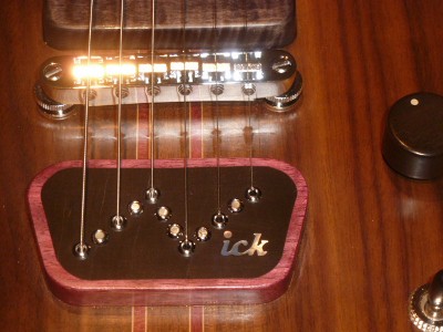

Some people have trouble reading this, but the new owner's name is Nick.

Very nice work Charles and welcome to the forum! Very clever spelling of "Nick" too.

That's a very beautiful guitar. Do you have any sound clips?

Charles Faulstich wrote:Here are some more photos. Pickup covers are flamed maple dyed black. Ebony inlay on back is to cover a hole drilling tear-out.
No, no, no! This "feature" on the back is a matching inlay, opposite the clever tailpiece on the front!
Cool, compact design. I hope that purpleheart stays bright next to the ebony, 'cause it looks great.
