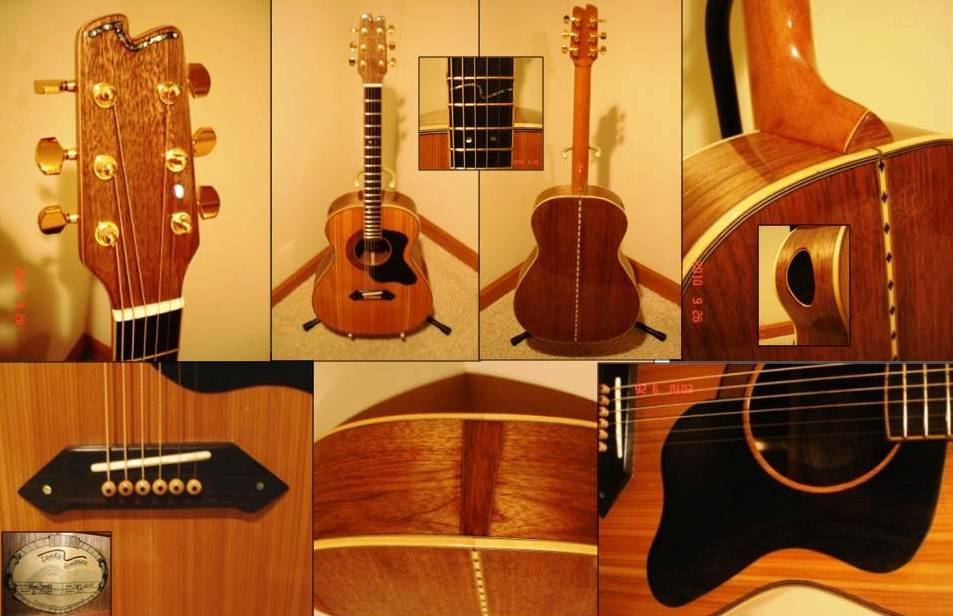

OK, I'm back on my laptop finally to try posting. I was not able to select "browse" on my iPhone but I could post text with no problem and see images already posted. Just thought I would post a pic of my first build, finished a little over a year ago. This is a collage of images actually. Hope to start #2 this winter, as soon as I heal from shoulder surgery. Getting close.
Zentz Guitars, #001
Zentz Guitars, #001
Re: First Acoustic Guitar •pics•

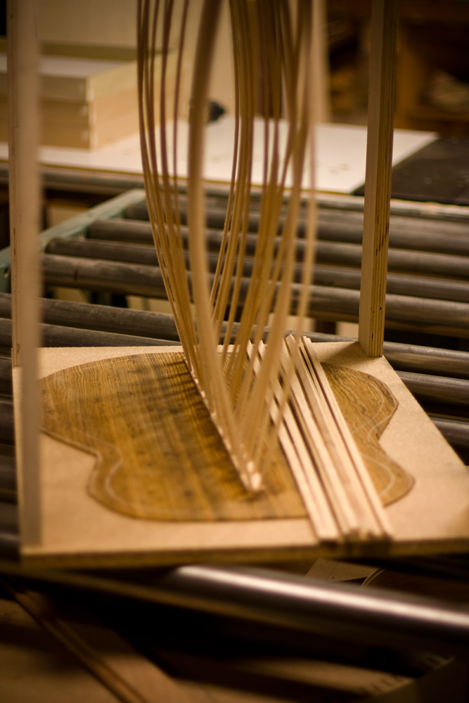

Cool, the pics look good too! Did you use a radius when you glued up the top and back? I didn't see a radius dish in the go-bar deck. You really should put the dome in the top and back.

No arches or domes on the braces. The top will have 2º angle from the waist to the neck same for the back. I should've arched the back but I'll see what happens to it in time. The struts are pretty stout.
