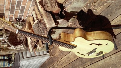

Here's how the small archtop looks so far: (sorry about the sideways - no idea how to fix that). It's a 14.25" full carved archtop guitar, using my Guitar Octave Mandolin body design and guitar neck, 23.5" scale. Front plate is Englemann, back, neck and rims are curly red maple with interesting mineral streaks.
There some scratchy areas, but more of the brush mark type longer divots where I needed to level sand more. I waited (after the 5 day initial rub out shown here) to see if there was any shrink back, etc. but I don't think there was. This is most pronounced on the front plate. Maybe not a big problem, but I want to get it better. (No blue or other haze that I can see).

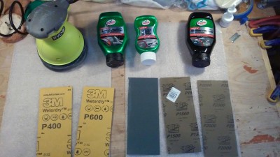

Here is what I am using for sanding and polishing - automotive compounds. I don't have any micro mesh but really need to look into that. I would have been thrilled to have the finish shown on my first builds, but now I really want to get closer to a professional level. (Some local pro musicians saw the guitar at a show last night, and they did not notice the finish flaws. They just liked the wood, and the playability of the smaller body size).

OK, so last night I disassembled the guitar for sanding and polishing. At this point, the finish has been curing for 12 days and the odor is nearly gone.
I went almost all the way back to the beginning, doing the entire body with each step:
- Wet sanded 600 grit to level out the brush marks and a couple of areas I had scraped flush with a razor blade. Used water with a drop of dish soap, just enough to lubricate.
- with the finish now leveled, I can go through the finer grits. 1200 grit wet removed the last traces of brush marks and scratches.
- 1500 grit, then 2000 grit wet created a dull luster
- Turtle wax rubbing compound. More shine than I got after the 5 day level and polish.
- Turtle wax swirl and scratch remover. Looking pretty good.
- Turtle wax polishing compound. Looks really good!
So, after 12 days I got a very good polish without too much trouble. The result has a deeper shine than the 5 day results - could this be partly due to removing more finish?
