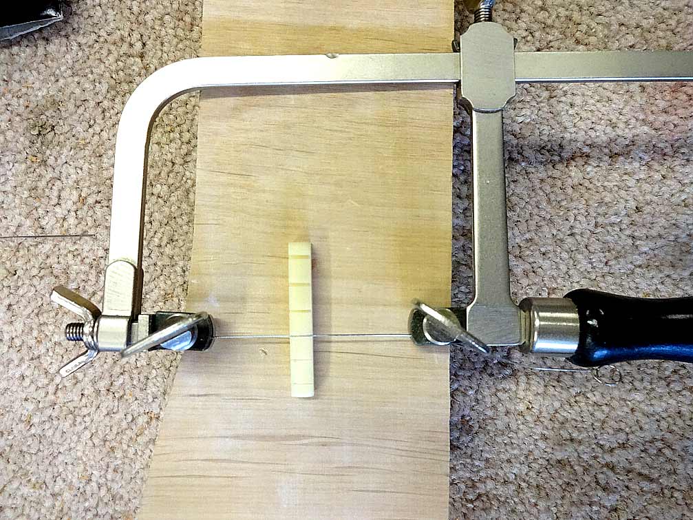

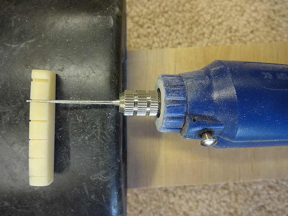

Just thought I'd add a few pics of my cheapskate nut slotting tools, since I'm making some nuts (from soup bones, of course). I'd like to afford gauged nut files, but a couple hundred bucks are not in my lutherie picture. I mark, then cut all the slots to depth using a jewelers' saw.
For the slots under 0.015" I've selected some jewelers' saw blades of the appropriate kerf. For slots around 0.020 to 0.026 I use welding tip cleaning files in the jewelers' saw.
For slots up to about 0.060 I use a bead reamer in a rotary tool. I measure the fit using the appropriate guitar string.
For larger slots (basses) I can get needle files into the above slots to enlarge them. I only make 5 or 6 nuts a year, so this method is not too egregious.
