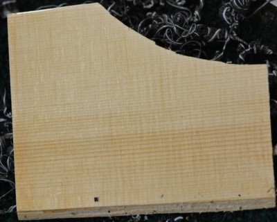

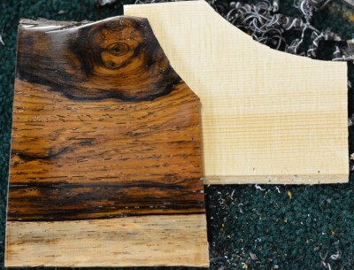

Okay people - I buffed out my sample pieces.
It was actually very easy to buff them out - I was shocked.
As far as preparation of these samples, I did not take great care to make them perfect. As a matter of fact I was doing it real time earlier in this thread, I was slopping the finish on with paper towel pads, and I sanded back with my cheap-ass papers (which leave the deep scratches you see). I sanded with 400, 800, 1200 - just those - and took them to the buffer. I have a big Stew-Mac arbor with 14" doubled buffs, and I use Menzerna medium and fine (both compounds are yellow/beige - whatever - they are old)
It is very difficult to take pictures of finish, but I think these shots show what they look like reasonably well.
The cocobolo sample has very little finish on it - I think it may actually be down to wood in the center. It still looks great. The area along where the sapwood transitions to heartwood has a reasonable amount of finish on it, and it is rockin' there.
The spruce piece has more finish on it, and it looks great. In person, there is a deep silking which is very attractive in the light.
This stuff is the bom - I'm using it for sure. I'll just have to avoid big sweaty customers.

Mark, it is - in fact - still a bit soft. I can mar the finish with my fingernail on these test pieces.
It has only been on there for about a week, and my shop is un-heated. In the frigid climes of San Diego, it can get down below 50F in here (yes, I know - shocking)
I'm assuming (perhaps wrongly) that since this finish has been designed as a Gym floor finish, that it will get harder than it is now - with time. It is a cross-linked polyurethane after all!
I still have some time before I need to put it on the guitar I'm building, so till I absolutely need to cut-bait and spray, I'll leave these pieces in the hot-box and see where we get in a couple weeks.
I think the good news is that it has that varnish look and feel. It adheres well, it sands well, it buffs well. If it hardens up as it cross-links, then we're a GO.

Status Report: Test pieces have been in the dry-box for the past few days, and - as expected - the finish has hardened up significantly.
I can see places where I was able to mash the finish with a fingernail before, and right next to to those sames spots, I am not able to damage it now.
Also, the finish has shrunk back into the pores a bit - so I will be waiting longer to sand back on the real thing.
Still looks great, but the ultra-thin areas of the coco piece are now more noticeable - which is expected since the finish has shrunk and hardened.
