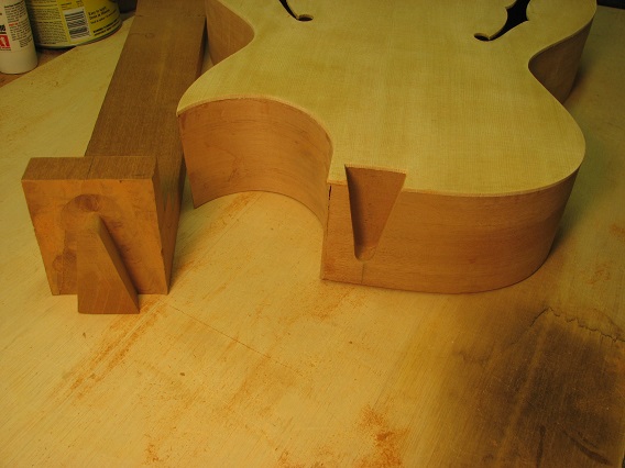

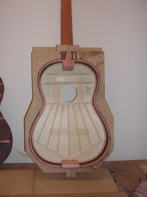

Bryan, I thought of that too last night after I made my previous post. I think the neck is just extra long with some material left to make a heel of the user's choice. If Keith made the scale length 650 mm (a common classical scale) then the 12th fret would be at 325. That leaves 15 mm (about 5/8 of an inch) to be used as a tenon. A straight tenon could be cut easily on a band saw except, as you point out, the cheeks need to be angled a degree or two. It would also be reasonable to make a dovetail (if telling a newbie to make a dovetail is reasonable LOL). I suppose you could also saw some slots in the side of the heel and make a Spanish foot but it wouldn't have the large internal block of wood, And, yes, there are people who actually just use a bolted or doweled butt joint - I think its a bad idea.
So, Keith, here is a bolted M&T joint (my preference)
a dovetail
and a Spanish heel
Pick the one you like
a dovetail
and a Spanish heel
