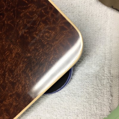

So sorry for letting this thread languish for so long, but I've gotten distracted by another project that I'm doing in parallel with this build (you'll see some new questions from me on that elsewhere), but I wanted to "close the loop" on this discussion.
The re-application of the finish came off good. Had no trouble with any witness lines, so it would appear that the GF HP is pretty forgiving w/regard to re-coat times. No indication that any of the subsequent coats had any trouble bonding with the earlier coats.
As suggested earlier in this thread, I was less aggressive in my sanding, shooting to have the last of the "shiny spots" disappear with the 2000 grit.
As you can see from the pictures below, I didn't sand-through this time. Finish isn't perfect, but for my second build if it comes out this good, I would consider it acceptable. What's interesting though is that if you zoom in on the edge of the highlight in the second pic below, you'll see some remnants of the cross-hatching that resulted from my changing the direction in which I applied each coat of the finish. This was a glaringly evident pattern when I began the final sanding, and my guess is that I should use a slightly firmer backing for the sandpaper (I have been using an old-fashioned pink eraser). I have some hard rubber that I think will be a better choice for level-sanding.
Finally, it looks as though I was damned close to sanding through at some points. Look at the third pic, a close-up that shows how the grain of the veneer started to telegraph through the finish in a couple of spots. Almost makes me think that the HP might result in a much thinner coat than the Enduro-Var, and thus might need more coats to get a good build.
Again, thanks to everyone for their encouragement and advice!

- Posts: 3249
Re: Sand-through with water borne lacquer
The final photo shows evidence of some finish shrinking from additional curing after level sanding. Maybe wait a bit longer next time. The cross hatch in the second photo is a bit strange. I don't know what is going on there. Probably the same issue.
Hmmm... waited a full week before doing the final sanding, but your observation makes sense. No reason not to wait a little longer next time.Barry Daniels wrote:The final photo shows evidence of some finish shrinking from additional curing after level sanding. Maybe wait a bit longer next time. The cross hatch in the second photo is a bit strange. I don't know what is going on there. Probably the same issue.
I was also surprised to get that effect in the last picture considering I filled with three coats of epoxy (System Three Silvertip).
- Posts: 1188
A couple of observations late in the game.
1. The cross pattern you see in the second pic, is most likely caused by the cross sanding pattern you used.
When I am sanding in between coats, I use a small circular pattern first, followed by going with the grain of the wood.
2. I find epoxy a great grain filler, and use it almost exclusively. It does require a bit more work to get it level.
I sand it down almost to the wood on each coat. I use 3 coats usually.
The finer grits of Mirka Abranet won't load up especially if you connect a vacuum to the block. However that "paper" isn't flat, it's woven and can leave ridges in the surface if you aren't very conscious of how you're moving it i.e. in swirls, not in straight lines.
Some of your grain sinkage may be due to the underlying epoxy coats which are extremely heat sensitive when power buffing. As the surface warms up the epoxy bulges out of the pores a little and then sinks back down a bit too far as the surface cools.
- Steve Sawyer
- Posts: 965
- Location: Detroit, Michigan
That's good to know. I'm using a small 3" random-orbit polisher that I don't THINK produces much heat, but might be enough if epoxy is very heat-sensitive as you say.David King wrote:Some of your grain sinkage may be due to the underlying epoxy coats which are extremely heat sensitive when power buffing. As the surface warms up the epoxy bulges out of the pores a little and then sinks back down a bit too far as the surface cools.
