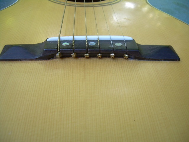

The bridge is made in such a way that the strings can slip out under the back if it when the guitar being put in travel mode. I use a bridge with a relatively small footprint and use small bolts (located under the pearl dots) and glue to secure it to the top. Before removing the strings I place a "bag clip" that I have modified with notches around the strings to keep the strings from tangling. The nut is also modified to hold the strings in place.

A gig bag can be a handy way to transport it as the neck part of the bag can be pinned over when the guitar is in travel mode and should allow it to be used as "carry on" luggage on airplanes. If you are careful when cutting out the port the grain can be matched with the rest of the sides. A strip of purfling or end graft can be used to move the port pieces out enough to fill the gap created by the saw kerf.
One advantage to using this type guitar as a "test mule" is it offers easy access to the inside of the guitar.
Using the traditional 12 fret to body versions allows the neck to fit inside the body with standard scale lengths and normal sized pegheads.
If you have any questions I will answer them as best I can.

Also, how has your pinless bridges held up?
I was afraid it would sheer off the top (like what happened to my classical guitar #1.

Solved the sheer concerns. Very clever! Reminds me of Kif's solution.Clay Schaeffer wrote:The bridge is made in such a way that the strings can slip out under the back if it when the guitar being put in travel mode. I use a bridge with a relatively small footprint and use small bolts (located under the pearl dots) and glue to secure it to the top. Before removing the strings I place a "bag clip" that I have modified with notches around the strings to keep the strings from tangling. The nut is also modified to hold the strings in place.

Although the bridges did stick pretty good I found they were close to the limit and over zealous tuning could take them past it. So I added some tiny bolts. I was looking at Michael Greenfield's pinless bridge design which uses a slot in the- middle- of the back and doesn't compromise the footprint as much, and I think I can modify it to have a semi traditional look and add string slots that will still allow the strings to slip out of the back. About 39 minutes into this video you can see his bridge design.
http://youtu.be/sAeXskZHC2o
