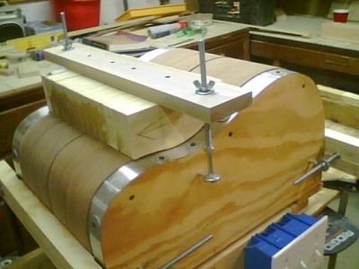

- Ryan Mazzocco
- Posts: 605
- Location: Joplin, MO
Re: bending machines vs bending iron?
this is the machine I built. I haven't had any problems with it. It's definitely not fancy, but it gets the job done. I can bend both sides at once with it.
it's heated by 6 120W bulbs separated into 3 zones, upper, waist and lower, each with it's own dimmer to try in an attempt to have better control of the heat distribution.
There is always some spring back with it, but once I put it in the form it's no problem.
