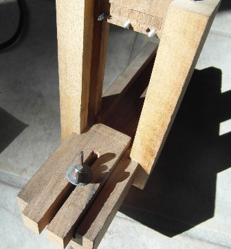

This is one more tool, a guillotine type of cutter to cut felt in consistent sizes.
Of course I made this with a few screws and a razor blade.
felt guillotine 1.JPG (28.77 KiB) Viewed 8172 times
felt guillotine 2.JPG (34.72 KiB) Viewed 8172 times
It works well, and I have used it.
