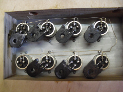

I've soldered the current transformer on the xlr-connectors.
I use a current transformer (1:100 but connected as a 1:50 transformer) for every string, but the (orange) magnete holder also is a single loop pickup. The pickup will be connected on the remaining connector (bottom-left), allowing me to play on a regular (bass-)guitar amp if needed.

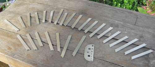

I took the frets out of the stainless steel plate and sanded them to get rid of the burr.
They are all cut to size to fit the corresponding fretslot in the fretboard.

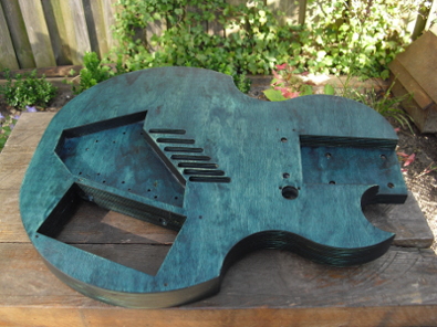

I've sanded the body up to 320 grit. I've dyed the wood three times using water soluble wooddye, sanding it lightly in between and finished it with a couple of coats of danish oil and a coat of furniture wax.

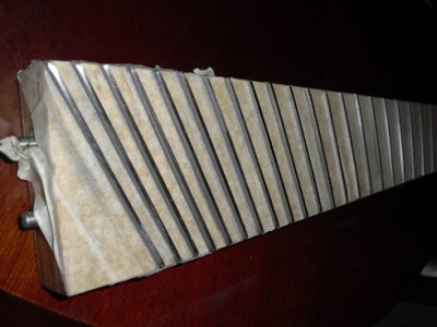

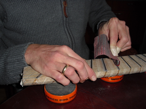

Finally made some progress.
I've made the neck and installed the frets.
I've applied several coats of Danish oil on the neck while sanding the neck with 800 grit sandpaper.
At the moment I'm recrowning the frets.
This is a tedious job because the stainless steel is hard to work with.
I use sandpaper to wrap around the recrowning file, else it will dull the file.
although it works, the sandpaper needs to be changed often.
When I'm done recrowning, then I'm going to make to finish the piece of wood which will hold the tuners in place.
I have to rethink my single string bridge because the watercutter wasn't able to could out the desired parts.
When these to tasks are done then it's time to string up the quintar and start soldering the wires and....finally get some playing going...
I hope to finish the project before the end of the year.

The frets are recrowned, and .... my fingers are numb....
The average speed was 4 frets / hour, but I'm done!

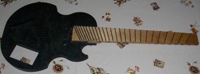

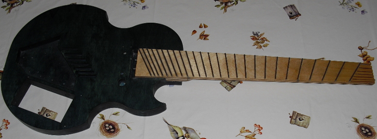

Finally it starts to look like an instrument.
I will wetsand some spots with danish oil to remove some small scratches of the file. Then I'll call the neck finished.
