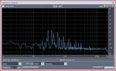

Here is the link comparing the second Prototype of the Violare Project to a very fine Lupot violin. This particular Lupot is known for it's volume and according to the owner ..."if you are aiming for volume, clarity/brilliance with a warm tone where it's needed, the Lupot is a great target"
I think this comparison shows what I thought of prototype #2, that there was more work to do. Please note that the video indicates Prototype #1, however, it is actually #2.
http://www.youtube.com/watch?v=4_xrVPgS-8M
Prototype #4 is going to John McLennan at the end of June for acoustical tests. Prototype #5, and the last in this series of experiments, is still on the bench.
Thanks for reading
Baz

Do You think You'll be able to reach the Lupot ?Barry Guest wrote: I think this comparison shows what I thought of prototype #2, that there was more work to do.
Re: Experimental Violin Part Two
It's nice to hear some comparisons. As we've been discussing, despite the obvious construction differences, there are more things alike than different between a traditional instrument and your experimentals.Samuel Hartpence wrote:The Lupot certainly has more volume/projection, but to my ear, yours is a bit more articulate and has more clarity.
Through my computer speakers, I'd say that the in-your-face-ed-ness of the two is pretty close, but the Lupot sounds a little "looser," more "relaxed," resulting in a bit more low end and depth.
Keep em coming!

Sam, thanks for that. However, I think you are being too kind. To my ear, the Lupot is ahead in all departments, but that doesn't phase me. It's a really good target and my prototype # 4 is yet to be tested. Also, #5 is in construction and should be finished by the end of July (we are currently moving house).
Number 5 is a combination of #4 and #1 with the slits curving back to the soundhole and then following the outline of the center bouts. This design provides an enormous free plate area (relatively speaking).
Beate, I do think #5 will compare favorably, and you must consider that I will be selling the Violare for about $1500, while that Lupot is worth $78,000.
Jason, I will keep 'em coming because I am convinced this concept works. Thanks heaps for your encouragement.
