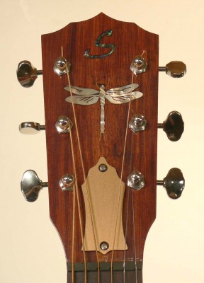

Re: Solving the 6th string intonation problem
Here's a photo of a peghead that I did with a compensated nut. I move the whole nut forward, and then using a small dremel router I cut back the groove to the point that I wanted.

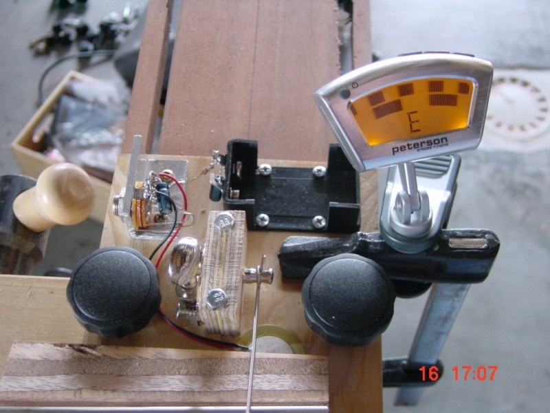

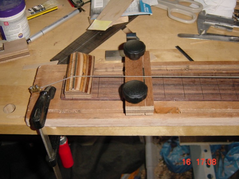

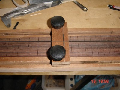

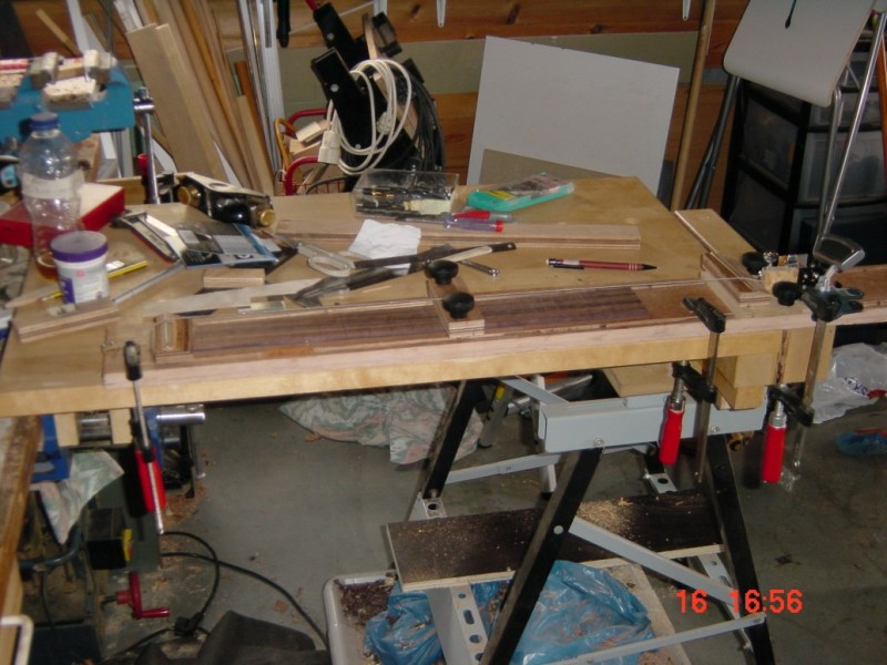

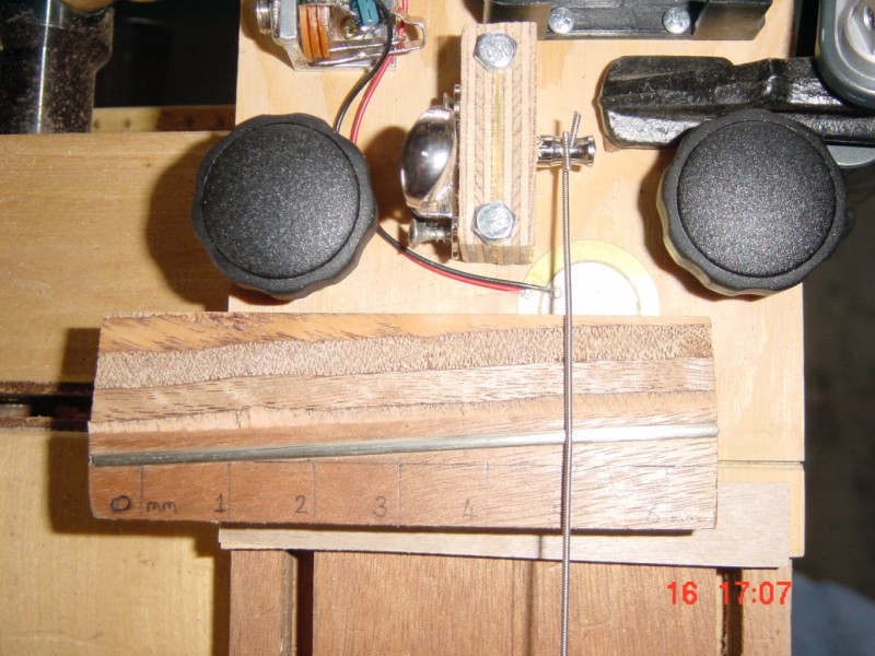

Steve Senseney asked:
"Does anyone have a precision method, or is it all guess work and luck?"
I have recently built a quick-and-dirty setup (which I rather immodestly christened the GNASHER – the Garland Nut And Saddle Harmonicity Enhancement Rig – without realizing Alan and others had been working on the issue and building similar devices!) to measure nut and saddle compensation for a single string at a time, more or less exactly in the way Alan describes.
The basic mechanism is sliders which engage in the fret slots of a sawn fretboard mounted in the rig (the nut position is initially just another sawn fret). The sliders at the nut and saddle end have long frets mounted at an angle to the string, so that sliding back and forth alters the point of contact with the string. These are calibrated with a zero position, which can be used to set to the nominal scale length, up to 6mm back for the saddle, and 3mm forward for the nut. A third slider has a straight fret mounted directly above the fret slot – this slider can be placed in any of the sawn fret positions.
First the desired action is set at the 12th fret by shimming as necessary under the saddle slider and third slider placed at the 12th fret (Gnasher Mk 1 uses shims; Mark 2 will have a screw adjustment to set the height of these sliders). The nut and saddle sliders can be set to the '0mm' position and the string tuned to pitch if you wish to measure the degree of sharpness using no compensation (measurement is by placing the third slider in a fret slot and fretting a note, reading the pitch deviation via the tuner output jack).
Then the iterative process Alan describes begins. The saddle slider is moved to lengthen the string, the string retuned to pitch, and the pitch at the 12th fret (or some higher fret if desired) measured with the third slider. The nut slider is then adjusted accordingly, the string retuned etc. Once the saddle offset is correct, the nut slider is moved to shorten the string, measuring the pitch at the 1st, 2nd or 3rd fret position with the third slider in exactly the same way. Then the 12th fret intonation is rechecked and the saddle readjusted. Eventually the correct compensation at the nut and saddle end is arrived at. I have not yet had time to do multiple experiments to check the repeatablility as Alan has, but I suspect there would be some variation, as he describes.
