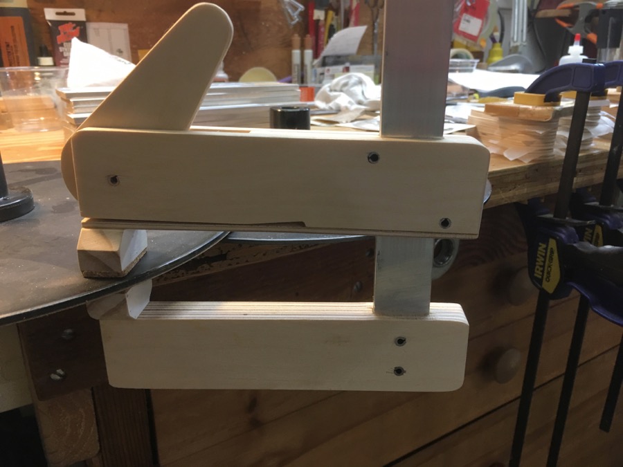

I am knee deep in clamps. Making them out of 1/4" baltic birch ply stacked 3 layers deep. These seem to work much better than the ones I made back in the '70s with the design in Sloane's book.
- Posts: 3249
Re: Restoration of a 1931 Martin 00-17

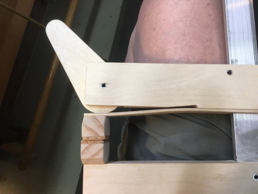

The flexible tongue is made from a piece of 1/8" baltic birch which is flexible enough that it can go into a slight "S" curve that allows the pad some swivel action, keeping it flat against the workpiece. I didn't really plan that but will take it as a bonus feature.
I added a small brass bushing on the cam.

I tested my new cam clamps on a bathroom scale and they easily can apply 50 pounds of force. I think that should be sufficient.
