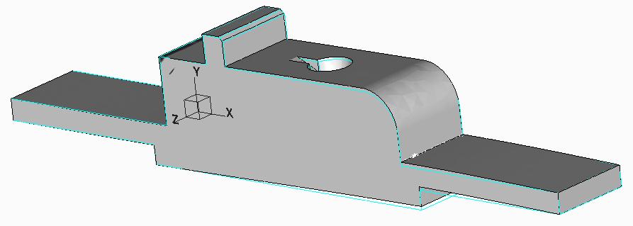

I made a few refinements to the model:
- The slice is now .45" thick (in the lateral direction), which corresponds to a 2.25" spring spacing (last model was 0.5").
- The bridge pin hole is now a 5 degree tapered cone.
- The string load is 28 lbs (it's a linear system, so any other string tension can be inferred by ratios).
- The materials are now orthotropic. Here are the orthotropic properties I used (data from the Wood Handbook and Trevor's book, all moduli in ksi):
Conventions
1=Long, 2=Radial, 3=Tangential
Poissons Ratio, NuPQ: P=Applied stress direction, Q=Lateral deformation direction
Rosewood
E1 = 2045, E2 = 284, E3 = 126, G12 = 252, G13=154, G23 = 52
Nu12 = 0.37, N13 = 0.60, Nu23 = 0.64
Spruce
E1 = 1579, E2 = 163, E3 = 80.5, G12 = 148, G13 = 143, G23 = 10.3
Nu12 = 0.40, N13 = 0.47, Nu23 = 0.48
Material Orientations
Bridge: Riftsawn at 45 deg, ring lines as viewed by player: \\\\
Top: Quartersawn
Plate: Riftsawn at 45 deg, same as bridge.
Conventions
Rosewood
Spruce
Top: Quartersawn

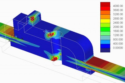

Here are the Von-Mises stresses on the centerline and top surface. I changed the stress scale compared to the isotropic plots, as the VM stresses peaked about twice as high. Compared to iso, the longitudinal stresses in the top propagate a long way under the bridge, probably because the top's E1 is so high compared to E2 and E3 of the bridge and plate.
I'll post some line plots that more clearly compare stresses due to different materials, hopefully tomorrow.-

First question--Would our bridge design work better if we tapered all of the edges to a much thinner edge? This would eliminate the "stress riser" effect.
Second question--All of the stress analysis is pretty impressive. Is it relevant without including the bracing effect?
I agree about the "mass" of the bridge (and bridge plate) being an important aspect of what controls the sound of a guitar.

I can't do reality checks in my head in psi. I only put psi in my car tyres, everything else is Pa. (or MPa or GPa).
However, if I've done the conversions right, there's a lot of wood failure going on in this model!

As David and I have pointed out in previous posts, the relevance of this analysis is dependant on the simplifing assumptions, and how completely they are satisfied. While neglecting the bracing does reduce the relevance of the analysis, this type of modeling can provide some insight into the internal stresses at work. Each level of detail that's added to the model may increase it's accuracy and relevance, but it may also add another level of assumptions that are not completely satisfied and therefore degrade the accuracy of the model. This type of modeling usually reaches a point of diminishing returns after two or three iterations.
David, do you have numbers for the displacement? I'm interested in the translation and rotation, within an order of magnitude.
I'd like to see a separate saddle added to the model, if that's not too difficult. It would also be useful for the back of the bridge to be beveled at 60° and 45° to see the effect on the stress risers at the back of the bridge.
I don't believe this analysis can produce any real_answers(after all, we already know the real answer is 42), but it is worthwile for the insight that can be gleaned from the results.

Steve, Trevor, and Rodger, thanks for the good points, questions, and suggestions. Comments like this are very helpful because they'll either improve the model, make its limitations more clear, or both.
Steve and Rodger, yes, after I made the first Iso model I tried some thinner and tapered edges on the bridge rear corner. But I was getting ahead of myself as the basic model first needed the kind of refining and vetting that is going on now. Those initial runs showed a 1/16" thick ledge reduced the stresses near the corner by about 1/2. I'll be running geometry mods more methodically in the future.
All, yes, the 2.5D nature of the model and lack of bracing is a major simplification. At least some string torque is off-loaded laterally/torsionally to the bracing. So this 2.5D model's stresses are probably over-estimates, and should mainly be used for relative comparision within model variations. For that, I think the model is appropriate, but a 3D model is planned for future. I'd like to stay in 2.5D-land until those effects are better understood, also because the meshing and solution only take about 6 minutes, whereas 3D will need hours or more. (Model development usually takes many dozens of runs to fine-tune the mesh, validate, and catch errors.)
On units, I realized that I gave the material properties in ksi (kpsi) but I didn't state that the plots were in psi -- sorry! My brain is calibrated in pounds and inches, but in the future I'll try to post plots with both psi and MPa scales. So on the prior plots, the Syy ones ranged from -450 psi to 450 psi (-3.1 MPa to 3.1 MPa), and the Svm ones ranged from 0 to 2000 psi or 4000 psi (13.8 or 27.6 MPa).
My aim for this model is to understand the interface stresses, but reality checks on wood failure like Trevor suggested are important. First, though, some general issues on stresses, plots, and failure criteria:
1. For orthotropic mats, von Mises stress has some problems. It does conveniently lump all stresses into 1 number, but von Mises (and principal) stresses are generally NOT the same across an interface of orthotropic mats (e.g., in the last plots, the high top stress migrated under the quiet bridge). Also, it isn't a good failure predictor for wood.
2. To describe the stresses across an interface, especially for orthotropic mats, the shear stress (Sxy) and normal stress (pressure, Syy) are probably best. They have to be equal and opposite across any interface (Newton's 3rd).
3. If the wood is in more than uniaxial stress, failure prediction needs a complex orthotropic criterion like Tsai-Wu (ugh). But we can at least look at ~uniaxial regions like the top surface behind the bridge--see below.
4. To predict glue failure, it depends on the type of glue. Regular PVA is probably ductile isotropic, so Tresca or Von Mises (calculated from Syy and Sxy) are good choices. I understand hide glue is extremely brittle (?), so max principal stress may be more appropriate. I don't know enough about Aliphatic PVA (Titebond). Does it have any ductility, like, even 2%?
So, back to the reality check on wood failure. The last plots for the top showed a large red region of high stress; querying that region showed a typical maximum principal stress of about 4600 psi, or 32 MPa (tension and compression on opposite surfs). At the very corner it goes to ~infinity, of course. The Wood Handbook says the compression strength parallel to grain of Engelmann and Sitka is 31-39 MPa. (One validation I ran was cantilever bending of an ortho spruce beam -- stresses and deflections were within 2% of textbook, so the solution of the 2.5D ortho model should be working normally... not that it simulates the braces, of course.) So the model stresses are similar to the compression strength of wood over a wide area (and higher near the corner) suggesting a good fraction of the actual string torque is indeed off-loaded to the braces.
Rodger, earlier I did a few runs with a very narrow slot behind the integrated "saddle". That allowed the bridge to hinge there, and made a "camel hump" in the pressure distribution, but didn't seem to affect the corner stresses. To do a downtown saddle, I'd need a contact condition between it and the bridge--doable but would slow the solution 10x. I can compare them to see if the simple slot is good enough. Or, it might work to replace the contact condition with some soft foam-like material with very low shear modulus. That would be speedy to solve, but behave similar to reality.
On displacements, the bridge rotates 0.73 deg (0.001" down at front, 0.018" up at rear), but the length of spruce fore/aft is rather arbitrarily set at 1" from the bridge (long enough for St. Venant to smooth end effects). I just ran some other validation runs and it looks like that length is having a small effect on the rear corner peak stresses. So I'm now doing a bunch of runs to find a length that is long enough to not affect the interface stresses. Will post updated results after that.
