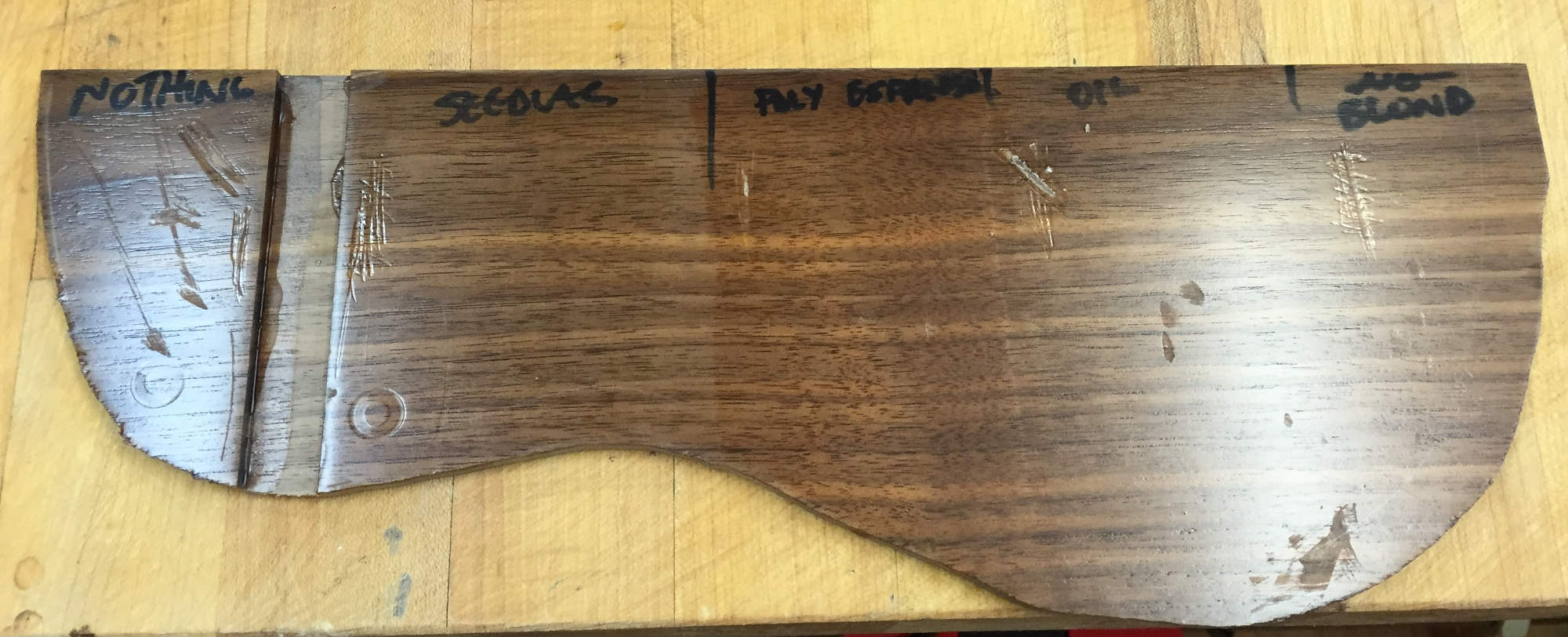

Second, I applied several different treatments to a piece of walnut (penetrating oil, oil stain, and waxy dark shellac) - then covered each of those with 2 sealcoats of blonde shellac - then 2 coats of Enduro-Var.
Then I abused it (pictured below).
NO PROBLEMS - same as above - all good.

Re: General Finishes Waterbase Topcoat - SM is pushing this - anyone tried it?
The oil is Liberon Finishing Oil. I put that and the oil stain on (2 coats), let that dry for a day. Then sanded back - which pretty much took it to a wood surface. Neither the stain nor the Liberon have much "body" to them. Then blonde shellac over that.
The oil was kind of a "worst case" thing - not necessarily a realistic finish schedule.
The "Nothing" section to the left is the control (left of the dato) - the majority of the piece has shellac as a barrier under the E-V.

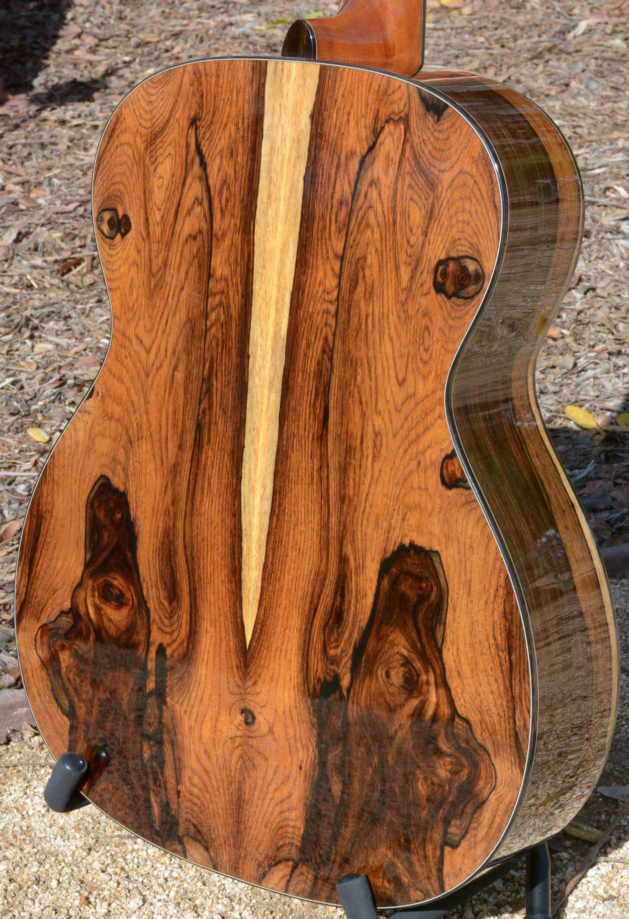

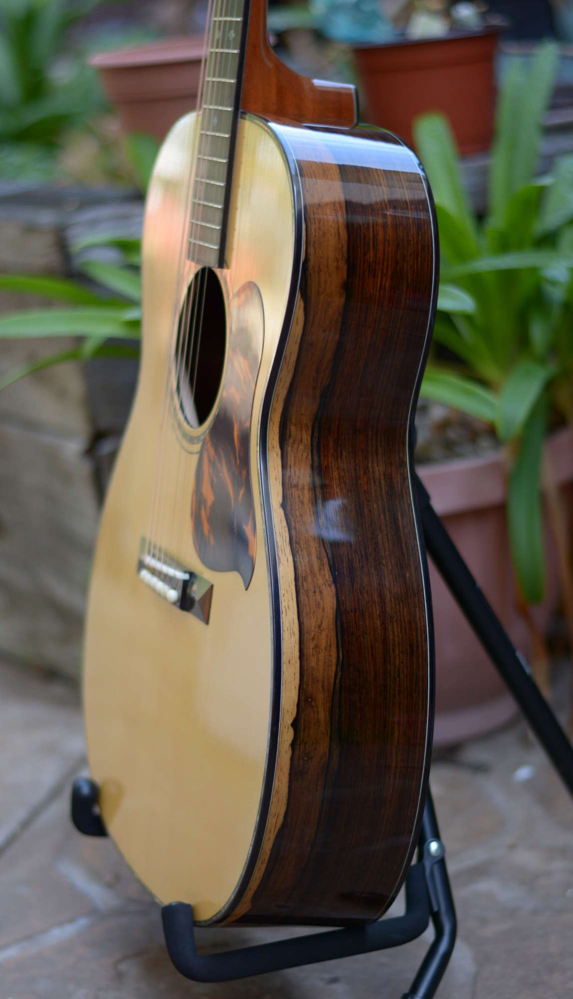

Some pix
This one is a bit washed out, but it does show how the finish really allows rosewood figure to show through. That was a very good thing about using it for this guitar.

Thanks guys, I appreciate the info. Chuck, that looks great. It sounds like the pros/cons ratio is favorable and who am I kidding, my skill level is well below the drawbacks of any finish. All my flaws will certainly weigh more heavily on the final product than not having 100% the look of nitro. . .

That looks great Chuck! Really wild.

Thanks Mark - everyone says the figure on the back looks like dogs. woof

Geckos!Chuck Tweedy wrote:Thanks Mark - everyone says the figure on the back looks like dogs. woof.
