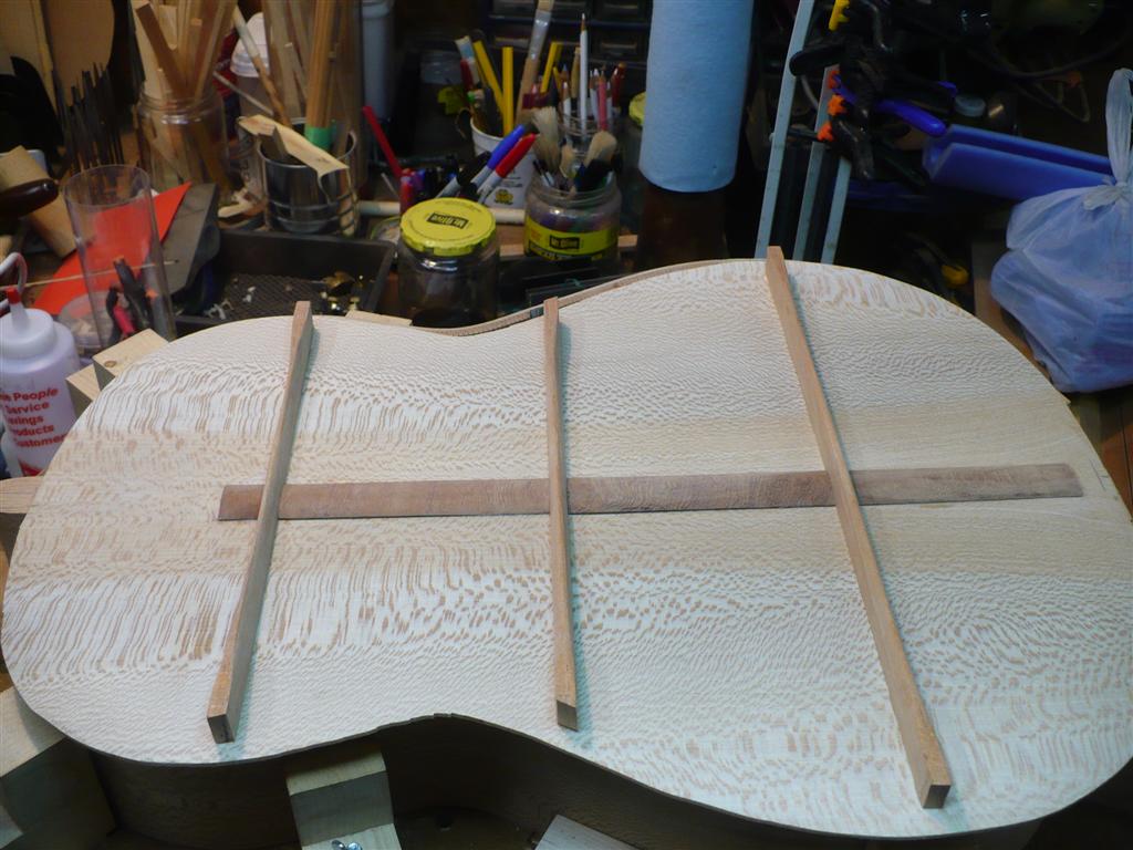

I do it the backwards way. I even fit the braces into the body, put double stick tape on them, set the back to the braces, align, press down and lift the braces out of the body. I clamp the brace ends in place, put tape dams on the ends and both edges, and glue them to the back. Then I fit the back strip pieces, and use a caul with cut-outs for the brace locations to align the pieces. Seems convoluted, but it works for me because my brace ends are at full height at the ends, and scooped in the center, and they sit on brace blocks glued to the sides. I also install my back lining with the braces sitting on the blocks. Easier to fit.
This picture is just before putting the tape and fitting the back to the braces. Everything has been sanded to the radius. Tape dams in place to glue braces down. Glued and ready to fit back into the box. I have tried it the other way, and every time I did, something went wrong. I've done the last 9 this way without a hitch, so far. The back braces are loose fit, and not glued to the sides, except for the block, to allow for expansion.
