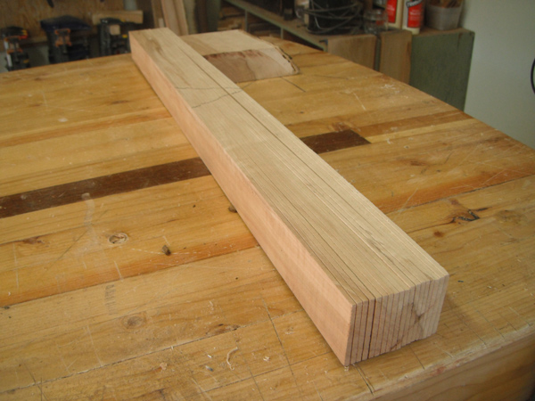

This is the apple billet I sliced to 3/32" for the ribs of the bowl. I harvested the apple in my backyard five years ago, so it is VERY local. I paid $1000 for about the same number of board feet slab sawn and kiln dried, so I'll say at 1.5 * 6 * 22" its around 3 board feet or $3.
Sliced apple billet
A shot of the sequence.
Rib blanks in sequence

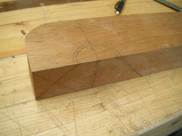

First step is to create the assembly that holds neck and tailblock in place for gluing up the ribs. Neck block is marked.
Neck block marked

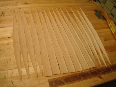

Sanded the ribs to thickness. Then, made a profile rib by bending one to shape, fitting it, and flattening it back into a template.
Here are the ribs rough cut (the center 7 have altered bottom shapes to fit the flattened back)
The ribs rough cut

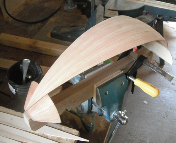

Finally, I got the first rib fit and glued in place.
Rib 1 in place (actually rib 8)

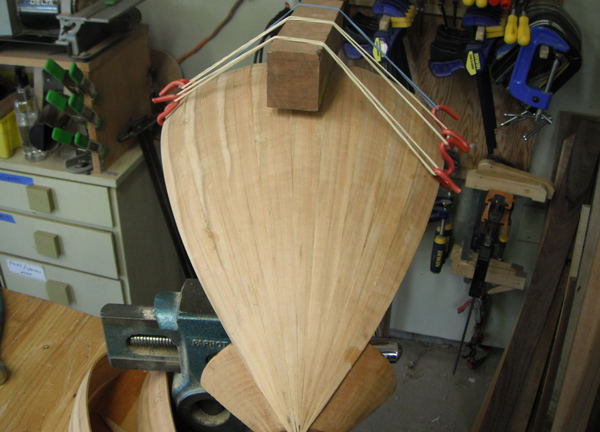

Postby Josh Humphrey » Thu May 10, 2012 4:39 pm
Thanks Andrew! In that regard, the ad lib is working out OK; there is something off with the geometry for sure which is making it end up overall about 3/4" narrower than the plan!! Once I get this one built, I can have a closer look and better idea how to get the next one right.
Yes, the neckblock was cut on the bandsaw.

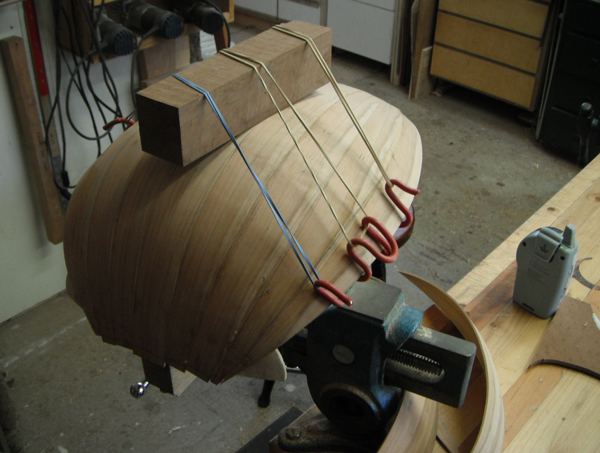

Here is the latest bottom view:
Bottom of bowl
And a front view. I am liking this improvised clamp situation.
Front

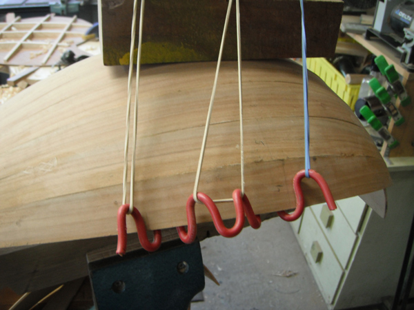

Finally- a close up of the new flexible clamp idea. Just add more rubber to get more power; it flexes to any part of the curve, and it pulls up towards the next rib each time.
Rubber band clamp

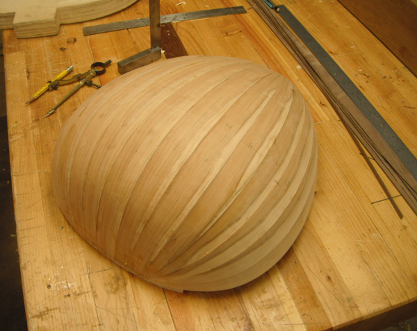

Postby Josh Humphrey » Mon May 14, 2012 2:17 am
The bowl, pretty much complete
Apple bowl

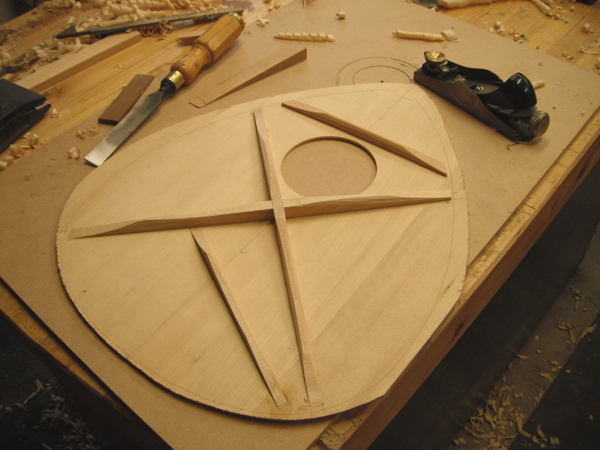

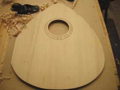

Now for the rosette- I have been developing this idea for the last dozen or so instruments. This one is spruce and walnut (shop made purflings leftover from another project!)
Soundboard rosette
And the bracing.
Bracing
Solid linings for the bowl; hopefully I can get the top glued on tonight and have half a chance of finishing...
Gluing in solid linings

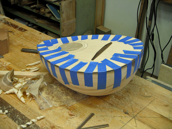

Got soundboard glued on this morning' very interesting to clamp! Then bindings- some leftover shopmade walnut with fir striping
Binding taped

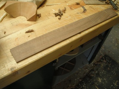

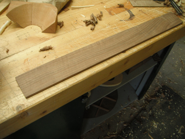

Now for the fingerboard: I saved a chunk of nicely figured walnut for this purpose, and resawed today. I got 6 boards out of an $8 piece; so that's $1.50. Here is the blank
FB blank

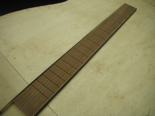

I slotted it, radiused, and glued on some ebony bindings (scrap offcuts of a previous fingerboard) with strips of maple veneer for a contrasting stripe on the sides.
FB bound
I will TRY to get the position markers inlaid tonight
