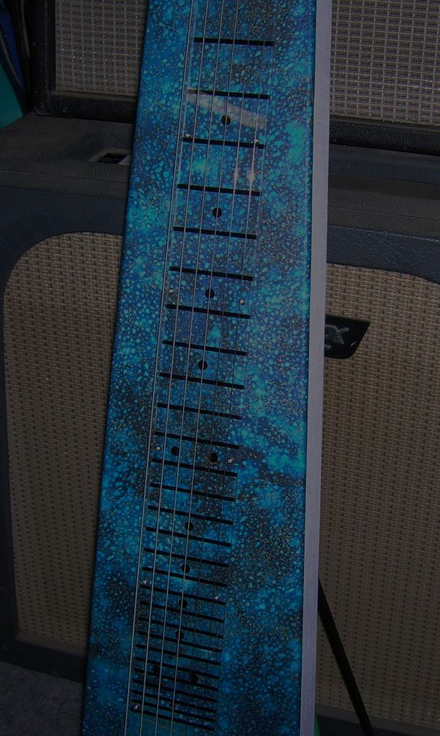

Could you show a close up of the acrylic fingerboard?

The fabric finishing is fun. Heres a tip. when you go to look at fabric take along a cutout of the shape of your body. you can then see how the pattern will look when reduced to its final shape. I've gotten some funny looks from salespeople as I stand there trying out different patterns, but sometimes something that looks great on the bolt doesn't look good when seen body size. Most of the patterens I've used came from the quilting fabric section. The patterns seem to be smaller and meant for a smaller area rather than for a garment.
Also I use a semi gloss polyurethane. I havent tried gloss yet because the fabric leaves a ruogh texture and I don't know how many coats I'd have to build up before I could start to level sand it. And on the lap steel it is a built in anti slip coating an the back.

Very pretty. I like the Star Trekky Carpet finish. I would guess it would be more stable on your lap
> "After the adhesive dries I give it a good coat of Minwax water based polyurethane."
Did you coat the carpet too?

David, I missed how you fixed the fingerboard to the guitar.

Andrew, I used #2x1/2 screws. These are the same size as the screws that are used on most tuning machines. I got them from my local guitar shop.

Quite a lot. The pickup is from one of those Tokai lawsuit guitars from the late 70's that I bought used a long time ago. It is 5.7k ohms and sounds real nice. The steel has a nice bark when pushed hard and cleans up nicely when you dial the volume down a little. The hollow body gives it a midrangey honk without too much of the ice pick in the ear high end that some steels have. All in all I'm very happy with the results.
