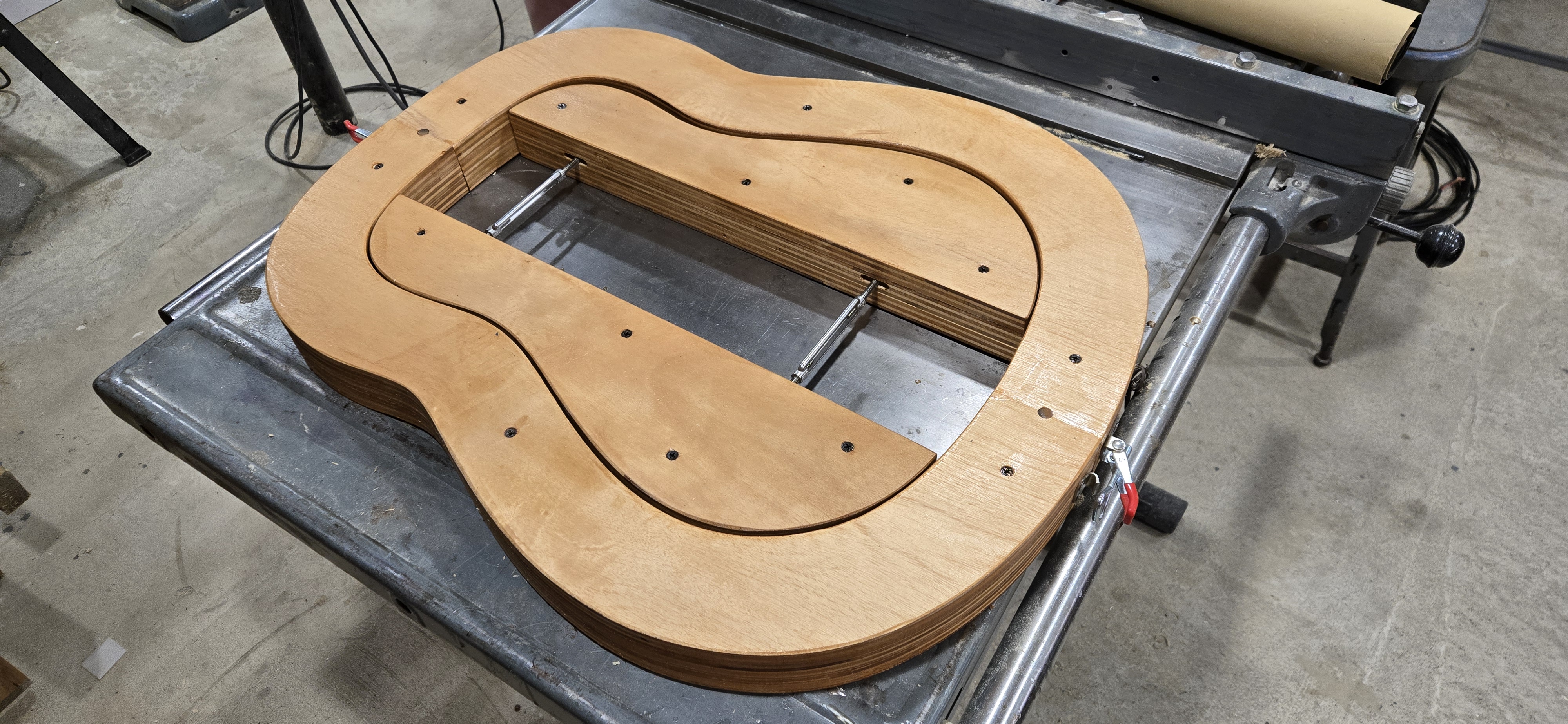

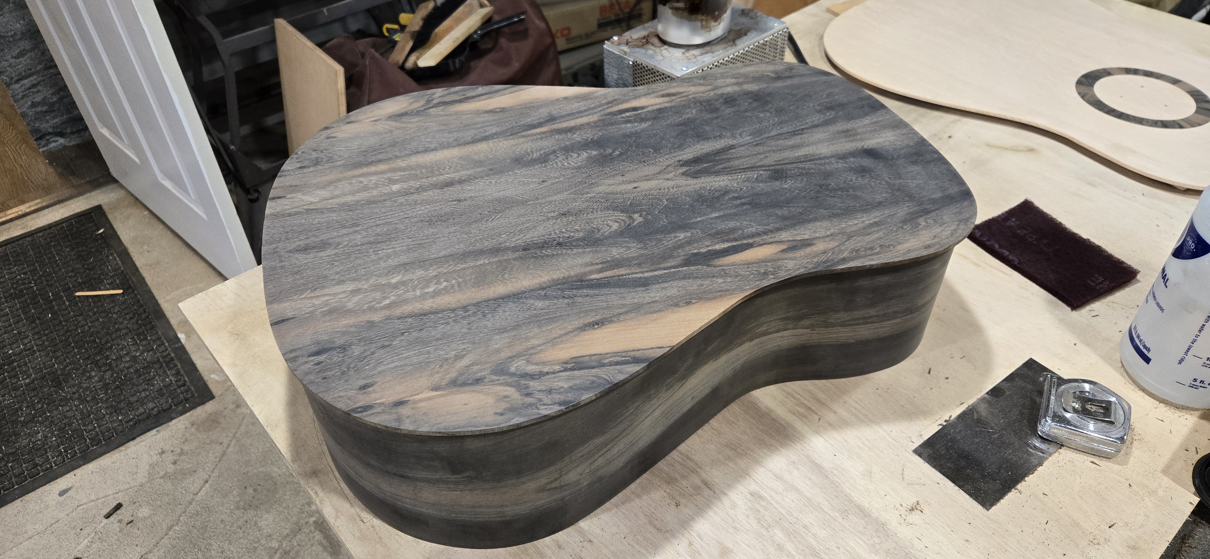

First Guitar Build
This is my first guitar, but not my first stringed instrument having built a cello a few years back. Not sure how much of what I learned from that will apply to building a guitar, but i guess I'll find out. I picked up a back and side set about six years ago because it was too cool to pass up and am finally getting around to the build. They are Brazilian Hickory with some crazy figure and the sound board is Alaskan Sitka Spruce with a bear claw pattern down the middle. I'm just getting started on the project, and thought I would post the progress before getting too far in and updare it as I go. The guitar is a dreadnaught, based on Gen One drawings, but I'll likely deviate from them a bit as I go. So far the plates have been glued up and thicknessed, and I made a radial rosette from wood left over from the back and inlayed it into the soundboard. The mould is complete and I spent the day scraping the sides to final thickness before bending them on the iron that I made for the cello. Next in line will be the head and tail piece blocks and contouring the sides, followed by bracing. It should be an adventure.
