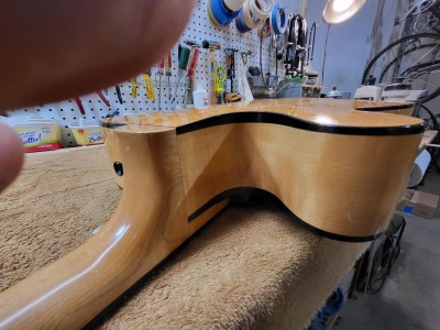

Patrick Hanna
Posts: 203
Re: Thick binding in cutaway of Gibson archtop
Post by Patrick Hanna »
You can contour the outside symmetrically and then cut the cutaway shape before hollowing the inside. THEN carve the inside asymmetrically. Carefully draw the shape of your sides and linings (inside and out) onto the underside of the top. Start your hollowing from the indicated shape of your linings. With this method, you won't have to make an infill to support the top, but you will still have some tall binding in the cutaway. I think in the long run it would be a lot easier to contour BOTH the inside and outside asymmetrically. This top happens to be asymmetrical on the inside and outside, because I did not want to struggle with binding that changed dimension in the cutaway. But it could just as easily be symmetrical on the outside. I hope this is making sense.
