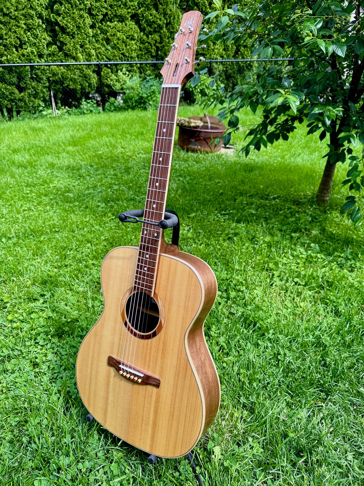

Hi, everone.
This is guitar number 4! I made 3 and 4 mostly together. Their tops, backs, and sides are from the same Sitka and Walnut boards. This one has maple binding instead of Katalox, a rosewood fretboard, and Curupay headstock veneer and bridge.
The walnut is from somewhere near me in Wisconsin.

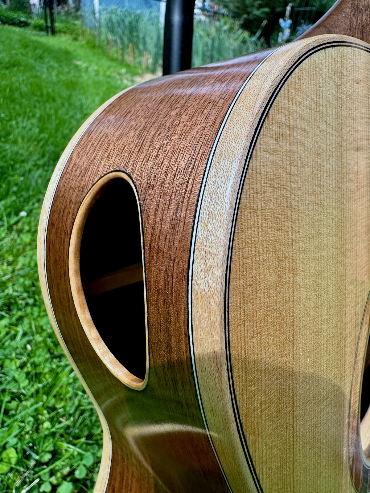

I now love side ports and plan on having them on all future guitars. You can also see the elevated fretboard, another feature I like.

On to number 5 and thanks for all the help.
Posts: 3249
Re: Number 4
Looks great, Eric. One suggestion: Move the low and high E strings 1/8” from the edge of the fretboard. Yours looks a little close to the edge and that can lead to strings slipping off the edge of the fret during play.
Eric Knapp
Posts: 650
Location: Wisconsin, USA
Re: Number 4
Post by Eric Knapp »
Barry Daniels wrote: Mon May 27, 2024 6:57 pm Looks great, Eric. One suggestion: Move the low and high E strings 1/8” from the edge of the fretboard. Yours looks a little close to the edge and that can lead to strings slipping off the edge of the fret during play.
Good tip. Making the nut and saddle are weak points in my abilities right now. I'll make a new set. All the videos, books, and articles make it look form straight forward than it really is. I don't have a good set of nut files yet, too.
Always more to learn.
Posts: 3249
Re: Number 4
I had to make several dozen nuts before I got my chops down. Saddles are a lot easier.
