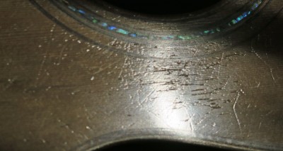

I would suggest putting a pickguard (clear?) on this guitar ASAP. You will be keeping this one forever I'd guess, and cedar is very soft. Sure don't want this to happen to you... I had just finished this one,(with the above cedar siding top) a first attempt at building one from scratch from a small picture in a book - 1840 Martin (kinda) Size 1. All excited to show it off to friends at the local guitar shop. Walked in, set it down in a stand in the showroom, went in the back to find them, and came back out to find a #!%* kid shredding away on it like a wildman. This is what 10 minutes of unsupervised cedar looks like.
