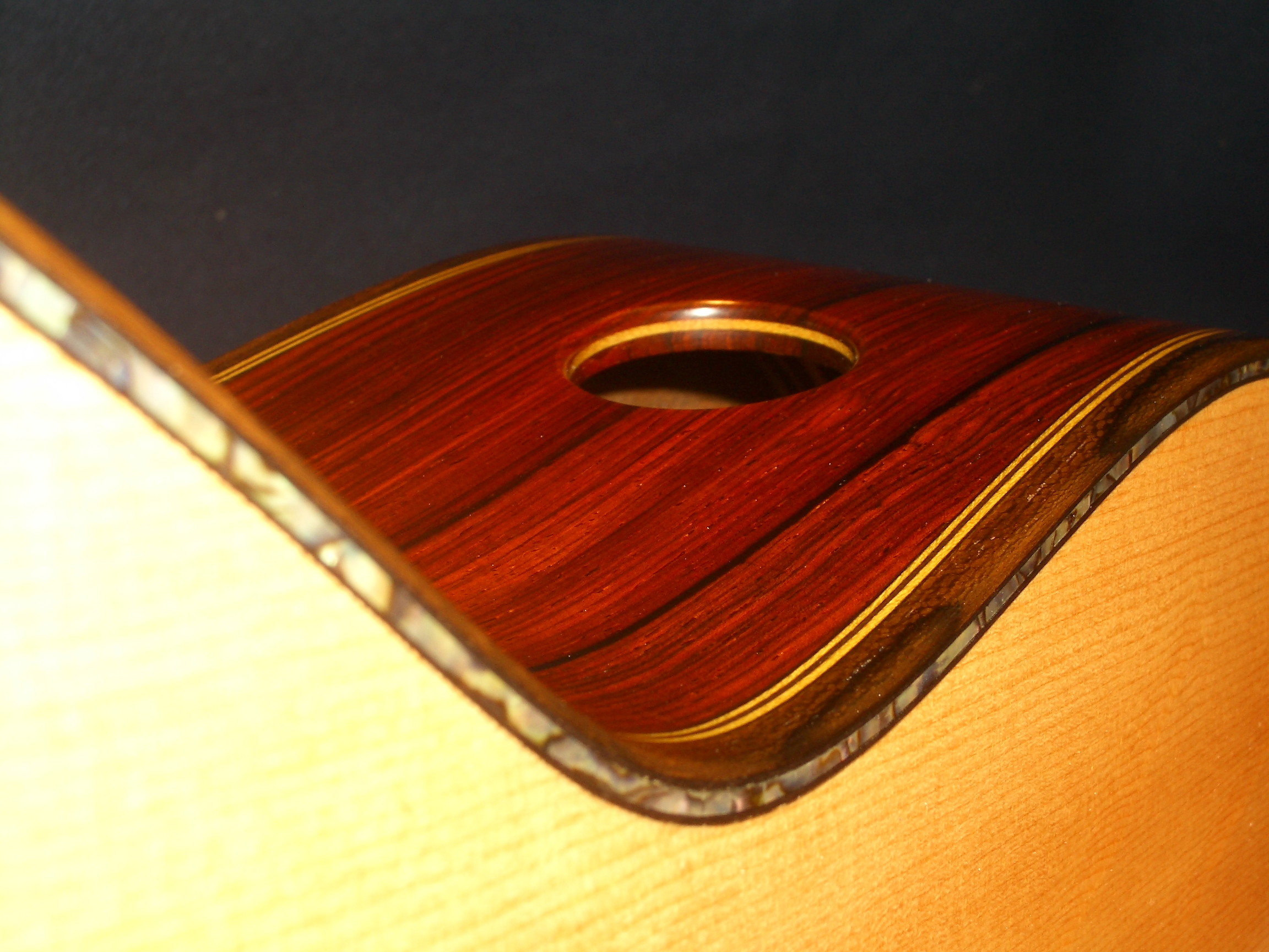

- Posts: 1390
Re: Binding Side Ports
That looks really nice!

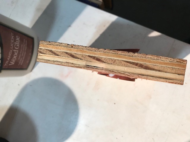

These are all great suggestions. My current guitars might need some binding though. The sides are laminated and I'm not sure how good it would look to show them. They are very stiff and strong already and don't need more reinforcement for side ports. Here's a photo of the edges of the sides. One is very thick and the is less so. The middle layers are basswood.

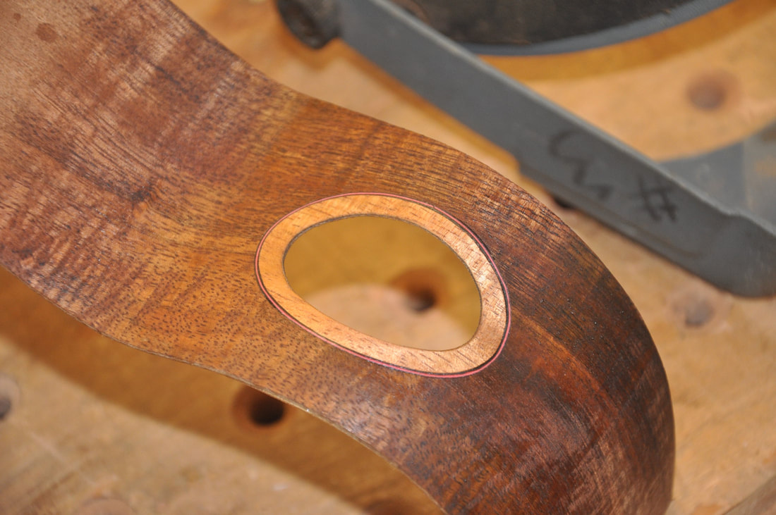

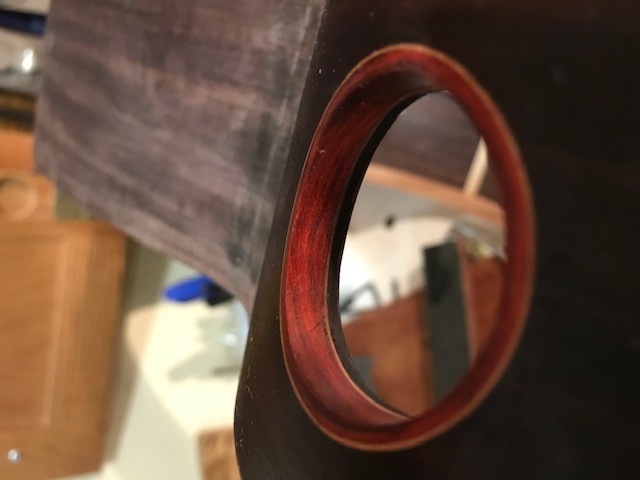

- Posts: 1390
I hope these pictures post okay.
This first picture shows how I glue up the scarf joint in the dummy hole. Squeezing the scarf across itself, forces it tight into the hole along the perimiter. The next shot just shows the binding plug squared up after gluing the layers. The outside layer is a cherry veneer to match the side purfling. This fits perfectly into the hole in the side then after it is glued in, I trim the height flush with the curvature of the side. In this last pic you can see that the scarf is visible (at about 8 o'clock in the picture) but doesn't look too bad. It is easier to hide in some woods than others. Also, after it was flushed up to the side, I glued in a layer of katalox to match the side wood on the inside of the binding.
